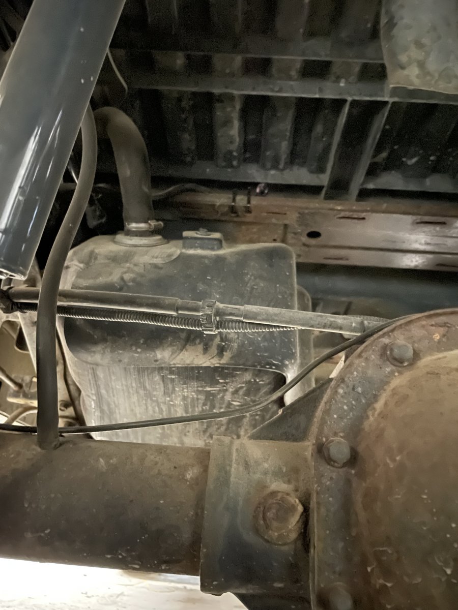

Yes the awd will go right in

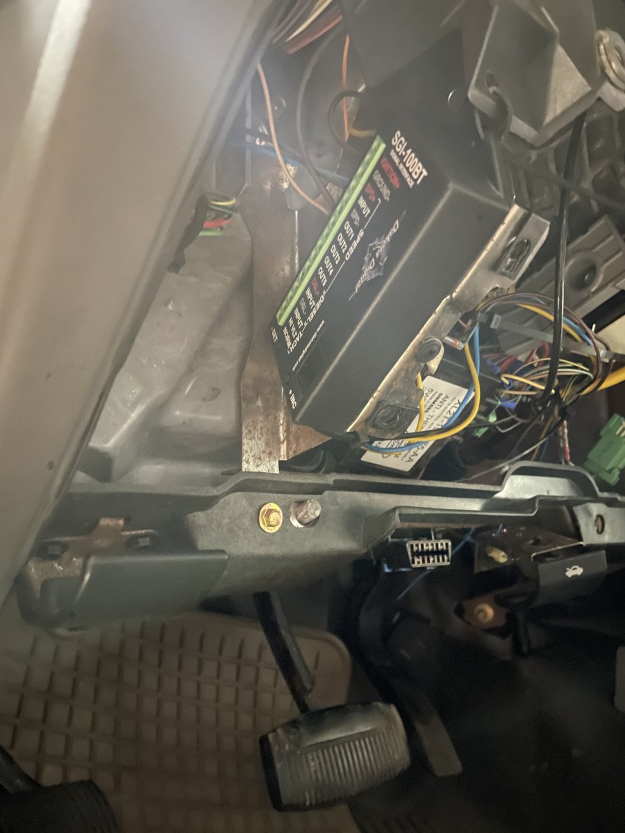

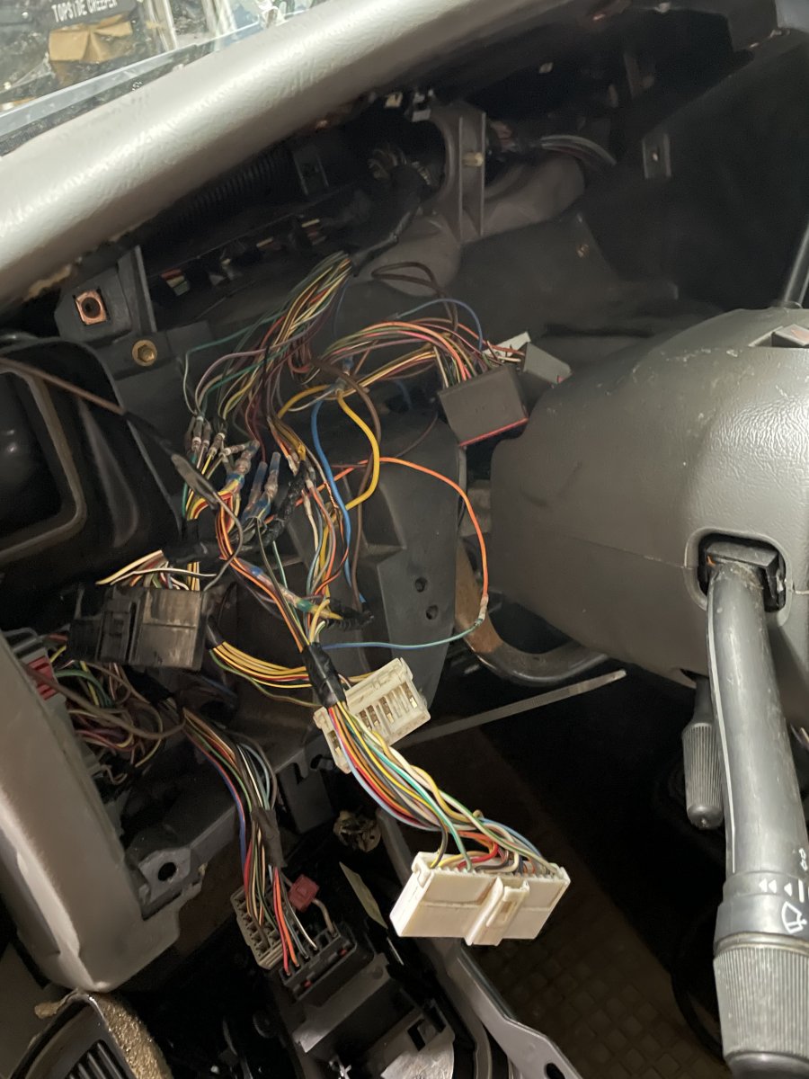

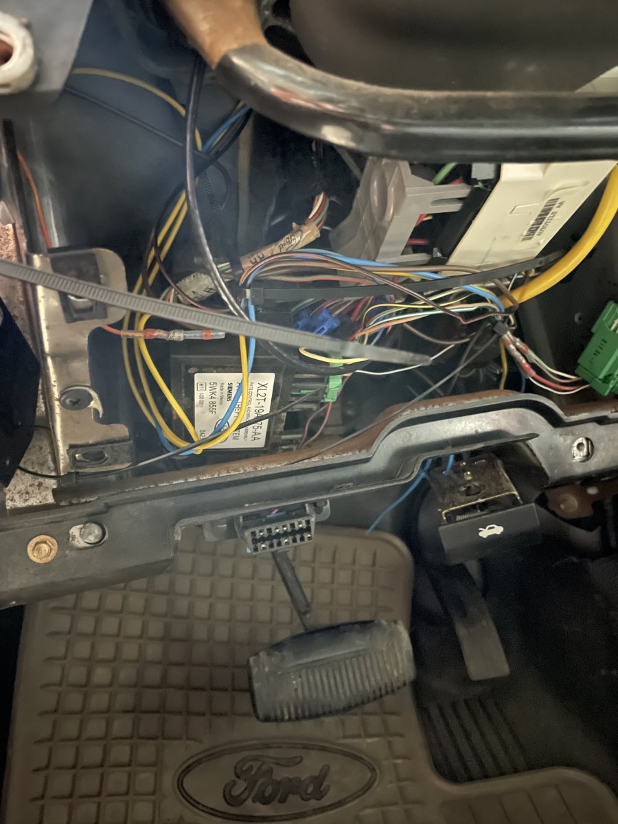

The wiring is easy enough 98-02 is all very similar, you do not need to swap the entire truck side wiring harness when it is really pretty simple to just wire the 5.0 drivetrain harness to the truck
