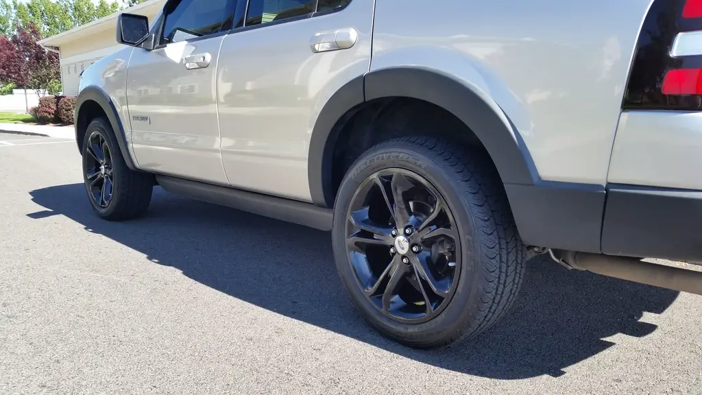

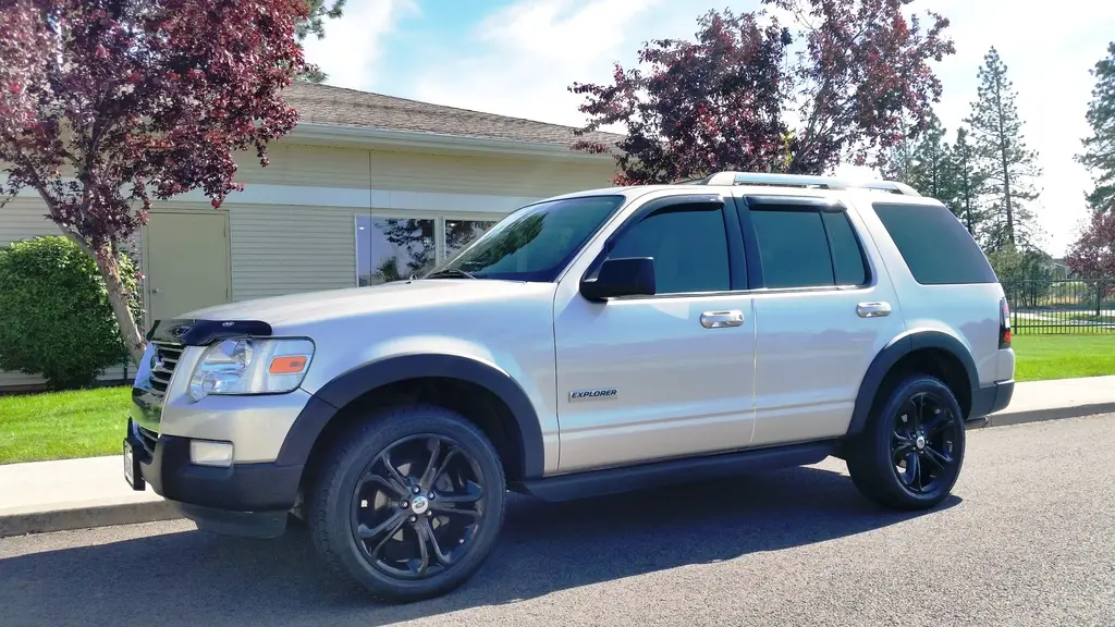

Pictures of 5th gen Limited wheels on my 4th gen.
Those are some great looking rims, well worth the money. I'm thinking of painting my wheels black, seen a couple on the 4th gen page that don't look bad with the spray. I went with a larger tire than stock and like the look alot better now, and I can keep my tire cost down some.
Previous owner had them powder coated black.
