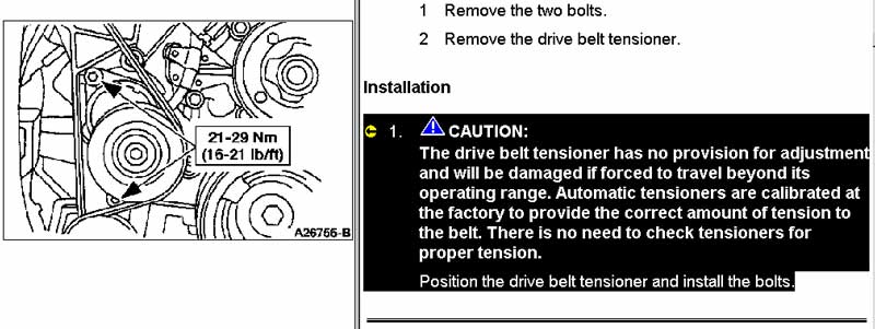

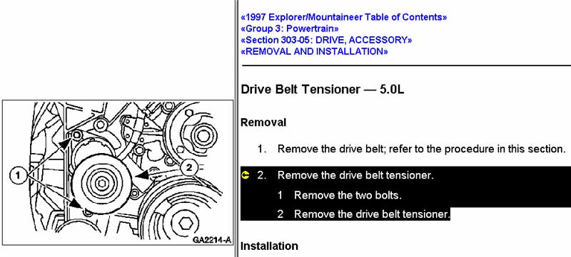

hey guys!
once again i turn to this board to see if any of you have had this problem. About two weeks ago my belt started making this god awful sound, kinda like a screaching. I replaced the belt, but the problem is still there.
I then pulled off the belt and turned by hand what pulleys i could. I found it to be the belt tensioner. Is this a common thing with these? Are they hard to change? I bought the replacement and its waiting to go on.
I also found a few other things that need replaced, the brake fluid is almost black, the power steering fluid needs replaced, and my egr valve that i just replaced a few months back is giving me trouble codes again!!
IN light of all my new problems, this is my work truck and i dont have a garage to change all this crap. I ended up buying a 94 chevy cargo van for a thousand bucks to get me back and forth to work, and it sucks!!! I really miss my AWD, not to mention its a chevy...lol.
So, do you guys think this is something i can do in one day? I dont want to freeze my ass off, but if i can do it in one day and get my explorer back, then so be it.
