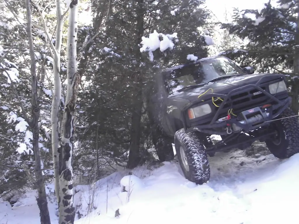

A good old fashioned come-a-long has saved my butt more than once. Definitely a good item to throw in the tool box. A highlift comes in handy too when used as a winch. Or both as seen in this picture, when even 4 chained up 37" MTRs couldn't keep me on the trail. Luckily for me (not my passenger door) a tree stopped me. I ended up working at this one for 3 hours or so. driving backwards, tightening up the highlift, driving forward and tightening up the come-a-long, and so on, until I was back up on the trail.
