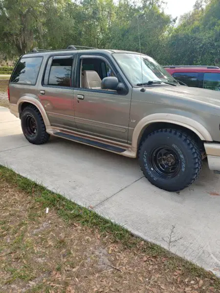

I recently purchased a 2000 explorer Eddie Bauer 5.0 for a steal.... Or so I hope. I do know it need some work such as leaking sun roof and most likely ball joints. However, what has be baffled is a binding feeling primarily while turning.... So far I've replaced the front drive shaft (awd), driver side CV joint, all 4 brake pad/rotors, and driver-side rear calilper. The last on the list I thought for sure was the issue.. However today (first time I've fully driven it on the street to work) I notice the binding feeling once again. Seems to me as if the the wheel bearing is bad however once jacked up wheel turns smooth with no feeling of binding or medal on metal. Does anyone know if the front is a full time lock?... On a side note the tcase viscous coupler and chain is bad I suspect. My plan is to eventually convert to 4wd with the 4406 tcase however I am planing on driving till I aquire all the parts necessary for the swap. Any ideas? Also sorry for the long post I hope I covered any preliminary questions.
