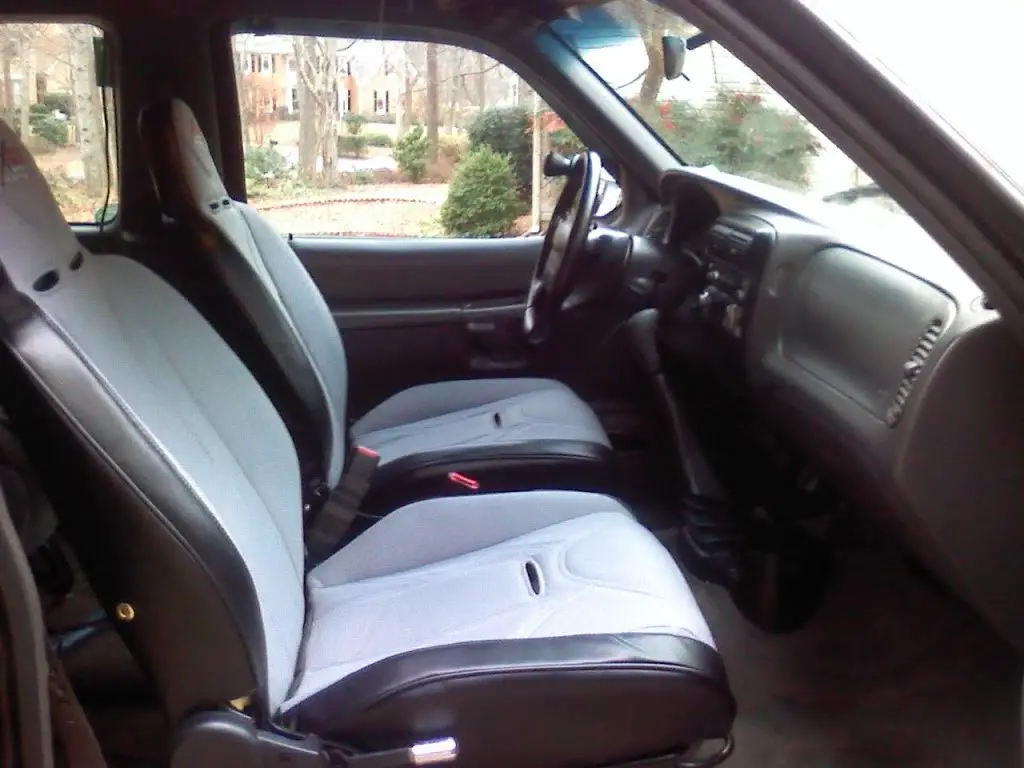

here they are!!! the grey/back two tone matches great

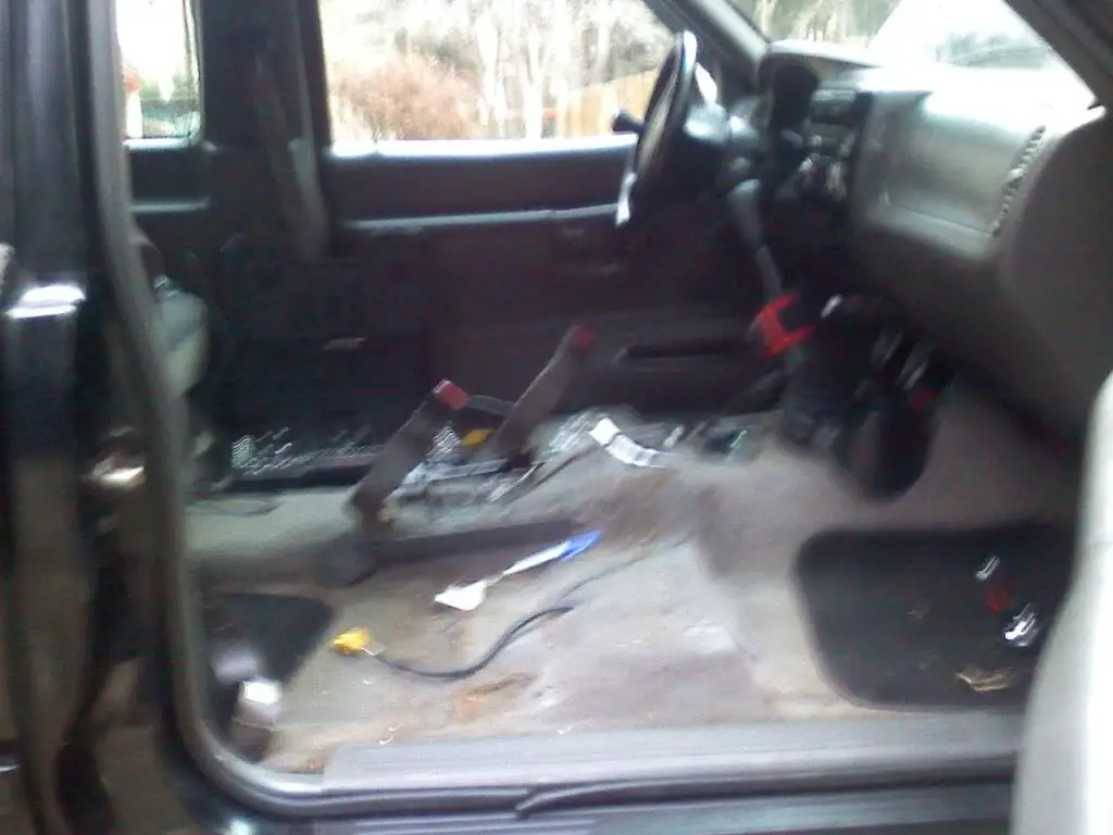

this is the lever that has to be cut flat. you wont need it with the new seats so just take the sawzall and cut the little hump off so the new seats will sit flat. im pretty sure this is only on the 2 doors tho

- first thing is to unbolt the old seats, sliders, and brackets from the truck. just take it all out as one. there are four bolts (10mm) holding it to the floor then two bolts for the seat belt buckle (also 10mm)
- second, get the old seat leaning against a work bench so you can take the brackets off. i suggest putting down a blanket if you plan on keeping the old seats
- unbolt the brackets from the seat itself. there are 4 10mm bolts holding it on. take off the slider and seat bracket together as one piece
- third step is to take off the little piece of metal (only on 2doors)(pictured below) that hits the slider when you fold the seat forward. it is no longer needed and you need the top of the slider completely flat to bolt the new seat on. just cut off the bar and the little hump
- now take your new seat (i suggest leaving on the plastic till they are in the truck) and get out the drill. the seats mounting holes are the same width apart as the holes on your seat bracket but length wise the holes dont line up. the forward bolt holes line up but the back ones are about a half inch above whee they need to be. just line up the bracket, mark where the new holes need to be, and drill new ones. its really not hard to figure out
- using the hardware given with the seats bolt the seat to the bracket (and make sure the brackets facing the right way. dont want your seat facing backwards!)
- bolt the seats back into the X and then take off the plastic wrap on the seats
- take her for a spin!

the day after i installed these i drove to alabama and after an hour on the interstate these seats still felt great! last night me and some buddies did a 5 mile mountian bike trail and when we got back to the car these seats felt even better. this is by far the easiest big imrpovement you can make and compared to other seats these are a really good deal. with amazon i even got free shipping on them. 4wheel parts sells them too but wanted more for them.
