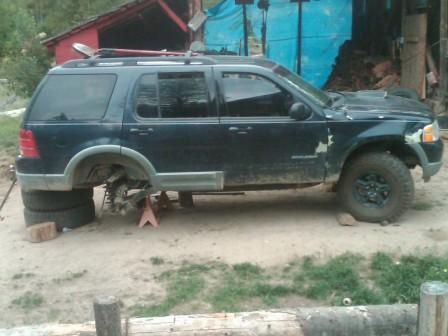

Well all of you that are interested; I have decided to SAS my 3rd gen. '02 Explorer, even though I am unaware of this having been done or any documentation of procedure/ parts used etc....here she is as of about a week ago. (on all fours now) -
I will be beginning with the design and pre-fab of what I believe will ultimately become the most basic, uncluttered, logical design for turning a IRS 3rd Gen (possibly 4th-5th?) Explorer into a SAS "go where ya dont really need to anyhow" daily driver.
First off, let me make a few things known as i hate to type, and repeating myself isnt a hobby or virtue i possess:
ONE - I have more "WANTS" than my wallet and wife will allow, so I'm going to be working on a very limited budget, (quite possible that it will end up also being the first "FREE" 3rd gen SAS) making use of what I already have, and turning what I have into what I need. As i have lived in the region for nearly all of my life, i have quite a few sources for parts, assistance, advice as well as the as deserved ridiculing laugh from the unbeliever.
TWO - I have a pretty good working knowledge of 4x4 Fords and want to keep ALL of my swapped in parts in the blue oval family, unless something is just "a given" and part availability/cost of replacement / ease of repair are going to deciding factors with what will end up on the rig.
THREE - As the majority of the fab work is going to be done at my buddies in his shop, and with this as my only rig!!, all work is going to be done with the ability to fit, try out, mock up,etc. and be able to drive home at the end of the day. as a result, i am planning on bveing able to when ready, pull in as IF/RS, and drop all 02 parts, then bolt up the SAS, bleed the disc brakes, grease the zerks and quick align the front before hitting the road.
Now, I know just as well as the rest of you that things -especially projects like this, NEVER go as planned...but i figure on keeping with what IS PROVEN and works (front half of SAS project), then I'm only left with having to be at "Murphy's Mercy" for the rear part of this project.
LET IT BE KNOWN also that as work will be progressing as fast as work, $$$, and my scheduling use of my buddies shop will permit, please try to be patient!!! I will post as new work is done, and as new ideas are brought to the thread. I also welcome any comments and advice, info on specs, any and all interchangeability info. I am not going to change mid stream any thing that would basically require beginning anew, so i will post this, collect suggestions, and advice, and will in my next post, outline what i have as my concept for REAR portion of project, using a Ford 9"/D44HP, disc brakes, reuse stock sway bar, and at least have a full 12-16+" of flex from ride height both up and down, with at least a 35" tire. I would like to hear opinions on most practical front SAS. Well gotta get on with the chores, so I"ll be posting plans soon. Thanks in advance for all the comments, etc. -Don Bush
