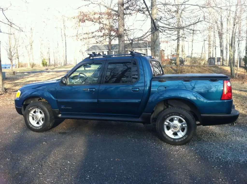

I agree with above as far as performance, you most likely won't feel a difference. I would also suggest trying for a 265/70 as I think my stock 255/70s looked small in these massive wheel wells. Tire type makes a big difference too. I have 255/70s in both of these pictures, but I think the ones in the 2nd picture look much better.
