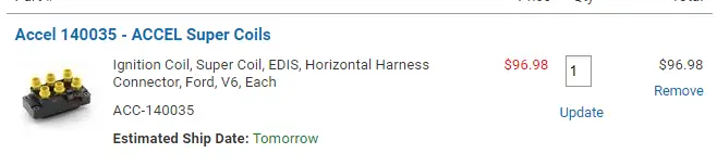

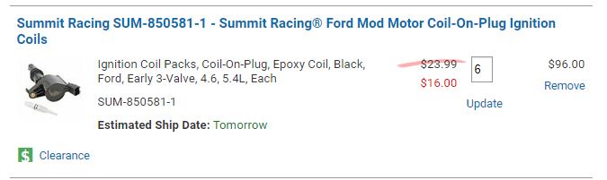

Coils - question, will these items work together? see pics
