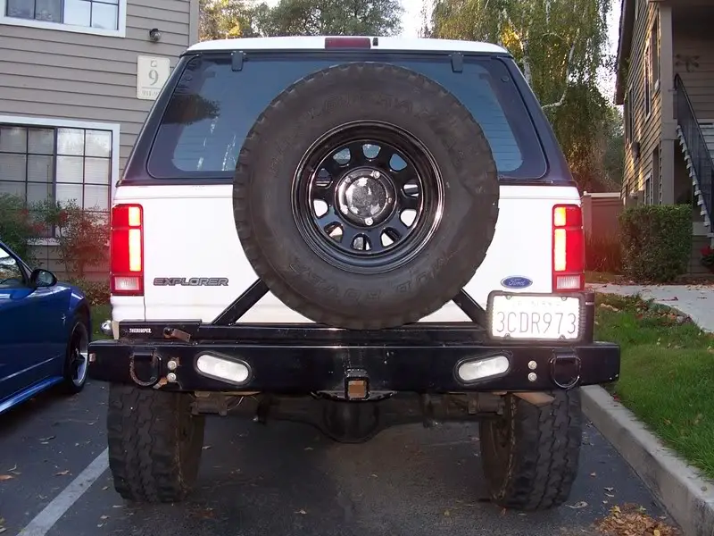

made this one in an afternoon and at a cost of $54.00 for steel. I took the bronco one off because with a full size spare and jack mounted on the swing gate. I was getting to much weight on the stock one.
hears mine.

i like your setup, now you have me thinking back up lights you just had to did'nt you!!
well i guess i won't put the pics up when i put break lights in there spot, and move them in more.:D
