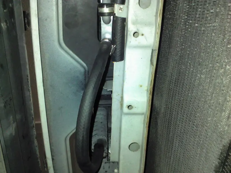

The cleanest trick is to unhook the return line under the radiator and start the vehicle and let it idle till the flow slows down. I've done this for 30 years, it wont hurt a thing.
The Nice thing is once the flow slows, shut it off and you can dump 4-5 quarts in the tranny and do it again to push the old fluid out of the torque converter.
If u have the Air to Fluid Cooler its safer to pull a Hose off the Cooler then mess with the hard fitting on Plastic Radiator - One could add a Petcock setup there.
I don't mess with hardline with an EX, under the radiator on the right side there is a short rubber line that is way easier to get to then the cooler lines.
On other vehicles I add a union in the return line somewhere handy and use that.
On 2001 Mounty 5.0 w/ Tow Package that Hose goes to Air to Fluid Cooler.
