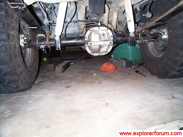

I have the Axle in the Truck but I still need to do more. The Shocks are toooo long but I knew that was gonna happen. I can t figure out the E-brakes yet. Drive shaft is too short and I need the the spring over brackets welded on.

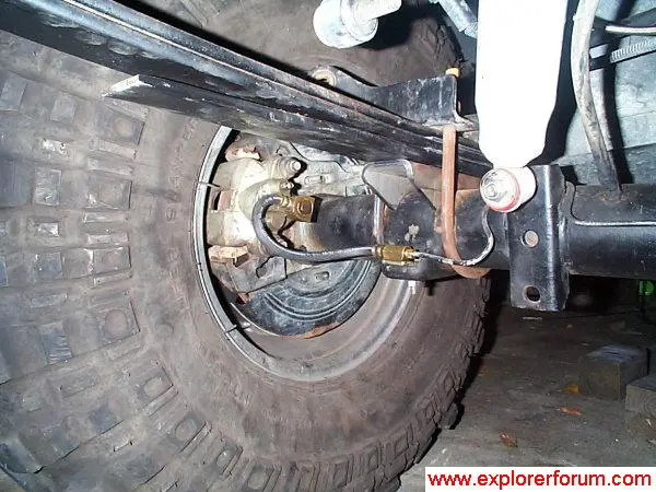

Kris, I have a quik question for you. I have had some major problems with my lower shock mounts. I heard that everyone just mounted them in the swabar holes, which was fine, but those mounts are side ways and too frar forward. The bushings take a beating and I am afraid it restricts my travel. Not only that, but I broke 1 off! It seems to me like the top hole would be even more of a hassel with it being too far forwar- have you had any probs? Also are your shocks the right length? If so what are they? Mine are too long and If I went shorter I'm afraid down travel would suffer. I am thinking of going with mudd***** suggestion of some universal ones from MOREDead Link Removed
But I don't think this would relieve the angle goofy angle. Any thoughts?
Kirby,
That is the Exact shock mount I bought. I had a problem with this mount because it is made for a much smaller Axle tube. It would have to be modified to fit on the 8.8

Kris, when you ordered the shock mount, did you tell them it was for an 8.8? The shock mounts that I ordered from them fit fine...
Another thing on thouse shock mount, where did you find them? I've been looking for a place that sells them, as I also don;t like the angle that my shock sits at mounted on my sway bar mounts.
I ordered online. The one I ordered said universal shock mount. I am gonna try to get the Spring over brackets done tomorrow. I will report back soon.

Isles- go to the shock mounts in the catolog on mountain offroad .
Mudd*****- Where did you put them at? Top or bottom of the axle housing? Are they out close to the spring pads? Did it solve the problem on them or are the shocks still in a goofy spot?
kris- The site says they are to alleviate the low slung shocks on an XJ- D35 housing. I bet a little grindage would fix them:D , but you should call them anyways and yell- you might get another set for free!
I am Gonna Try and take the Truck to a black smith today to try to get the Welding done I am going to take the shock mounts to see if they can do any thing with them.
The Blacksmith was able to make the Shock mounts work. All that is left with the Rear axle is the E-brake. The 5.13 gears are awsome. You could not make me go with any thing higher. It has so much Torque in 2wd, I cant wait to try it in low range. All that is left is install my Front axle and match front and rear lift, Order new Shocks, and remove some of the Body lift.
you got pics of those shock mounts.....I need to do something with mine cause I Have a spring over and and am using the old spots and cant run my sway bar.
