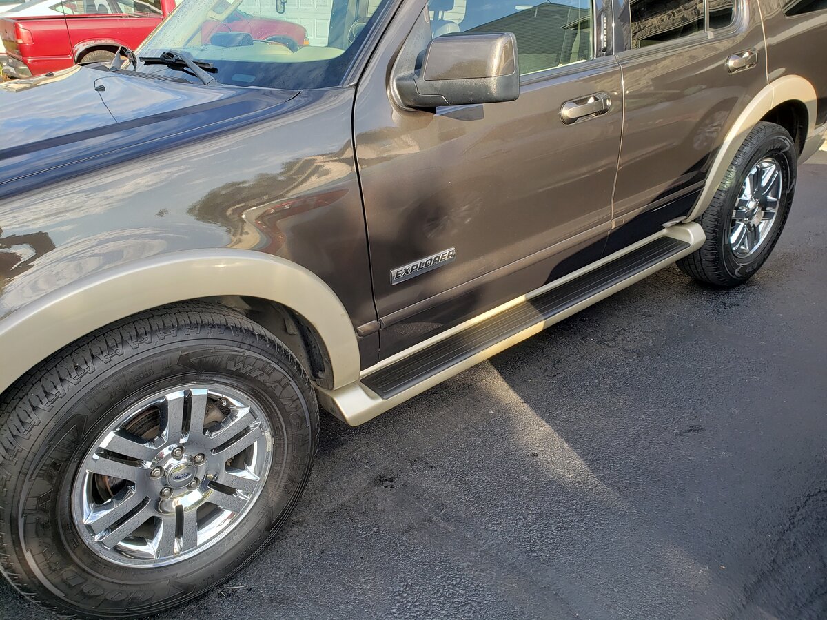

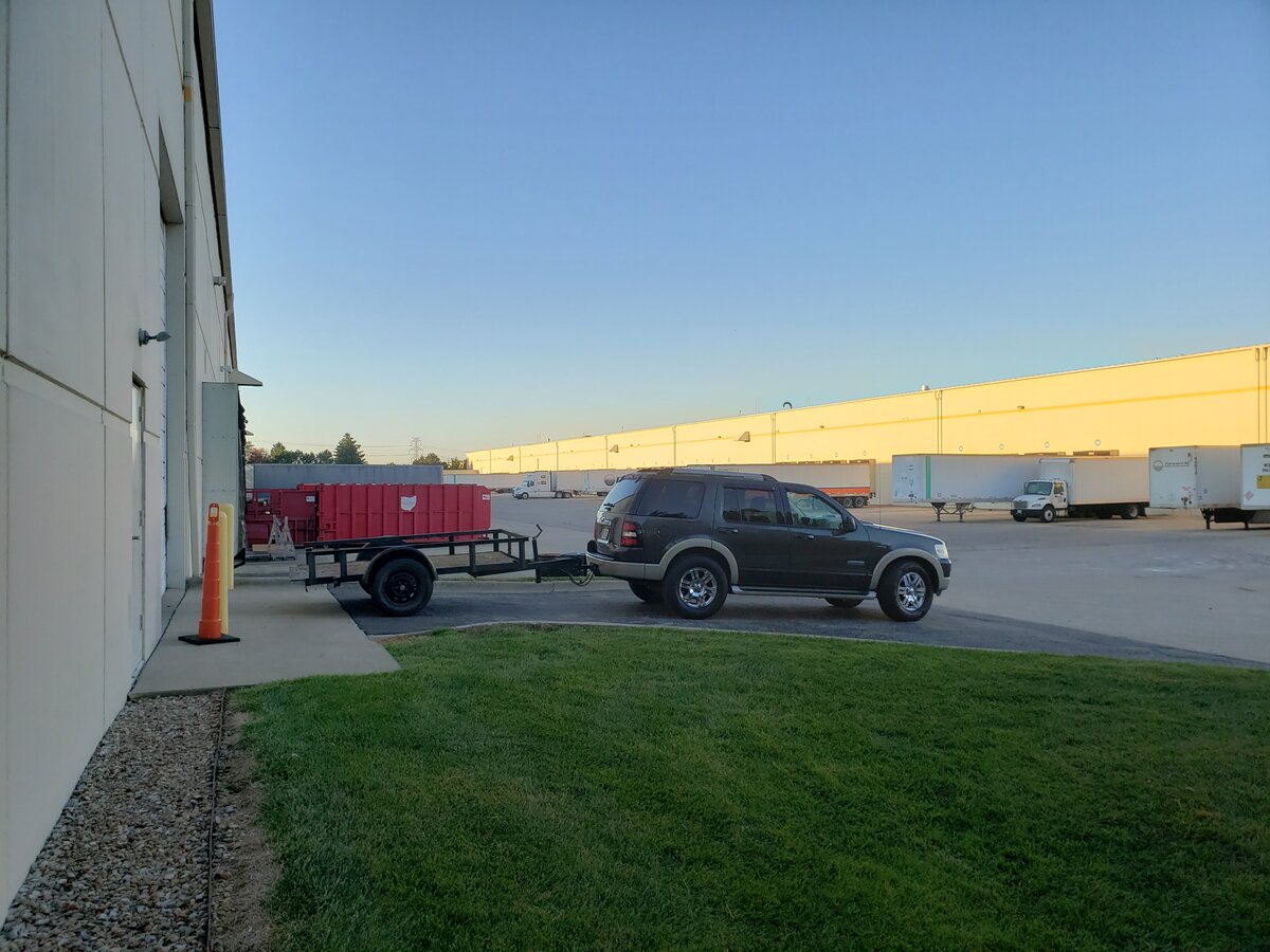

275/65 R18 on stock wheels 18 x 7.5. No Rubbing. Goodyear wrangler fortitude ht 275/65r18
