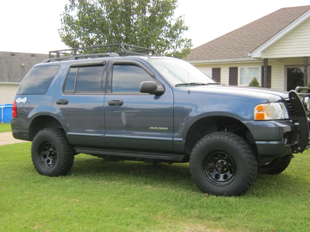

Rangermidtn - sweet looking rig. Looks like they fit fine although I don't have a lift on mine. I just like the look of those and you don't see many of these rigs modded at least around here.

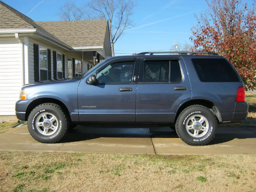

I'd like to see a stock 3rd gen with 265/75 and those rims. I've worn out the search feature and still don't have all the answers I'm looking for so my ride remains a soccer mom wagon.

I'm running 265s on a set of American Racing Baja 16x8s, I believe the backspacing is 4.5" and 0.00mm offset which makes my 265s rub like hell with no lift. I would not recommend wheels with significantly different than stock specs due to this unless you don't mind doing a lot of trimming. However, I do love the wheels though.
One thing to note is that the Cladding on the fenders does decrease the amount of room in the wheel well by quite a bit, but they still tend to rub on the fender's lip with the cladding removed when flexing out or going over speed bumps without slowing to a crawl.

Thanks for pic and info.
