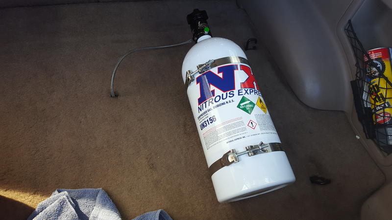

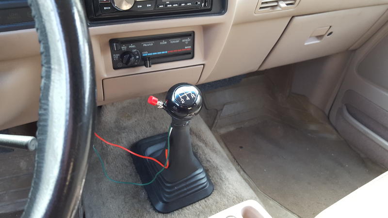

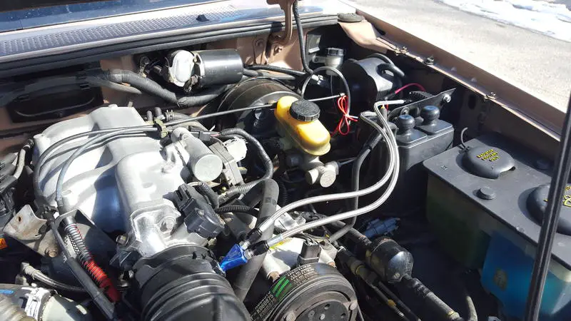

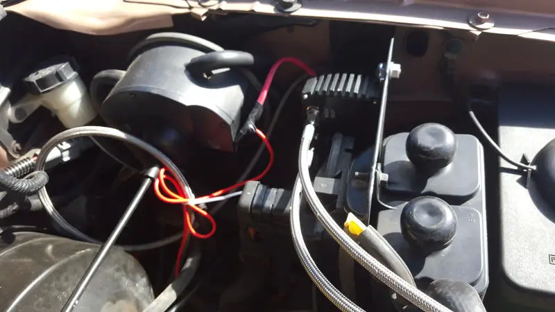

50 shot feels great. Definatly more noticeable than the 35. The only thing i've done to my Explorer is a KKM intake and a higher flowing muffler. I got a 10lbs bottle with the Lightning 500 valve. No purge kit, i didn't think it was needed.
I attached some photos of my setup. My engage button will be moved under my wiper button. The wires to the button switch will run through the shifter when i get some free time. The last part i need to install is a pressure release valve in order to pass tech inspection at the drag strip.

Nice. Yea i need one of those pressure valves too.you dont really need a purge,just lets the nitrous come in or on much faster..
You running a push button activation and not a wot switch??
People certainly dont expect a stockish looking explorer to have nitrous. Its funny how fast you can make something on Nitrous for so cheap..haha
I run a push button in shifter for now but think with new motor ill run it off a boost activation switch..
Yeah i thought it would be better to have more control over the nitrous for bracket racing in case im running faster than my dial in and need to slow down. Also its fun to be at WOT then fire the nitrous.
