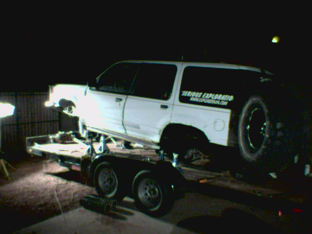

so, thanks to the floods in CA and Randy's sending me the wrong parts I've decided to take both axles off my truck and clean some stuff up.
Here is what I've done/am going to do.
Rear-
got the leaves rearched and a leaf added to bring up the rear to match front and clear the 37s a little better
moving the shocks to sway bar mounts for more travel
painting rear axle as well as cleaned up the frame and painted that
front-
completely took off axle, cutting down extra stuff hanging down from coil buckets
took off crossmember and building it with thicker steel, working on bigger mounts for radius arms (these haven't failed yet but I'm in prevention mode)
mounting shock resivoirs on the side of shock tower opposed to on the shock itself
clean up frame and paint that as well.
this is what happens when your truck is starting to get stripped down and you get bored waiting for parts.
