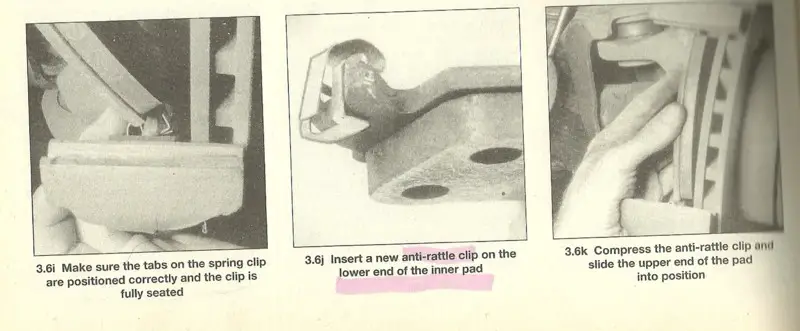

I have a question about the clip that goes on the back brake pad. I'm changing my pads and calipers today, and for the life of me I can't figure out how to get the damn clip to go back on the inside brake pad.
As I'm sure you know, the inside pad slides in to the rotor assembly area, then the caliper slides on top of it with the outside pad already clipped on it.
My question is two fold: First, is that clip really that important, and second, if it is, can anyone show me where it's supposed to go?
When I took the caliper off, the existing inside pad fell out with the clip so I didn't have a chance to see how it fit in there.
Oh, and I'm working on the front brakes, pass side. Just got a brand new caliper, new pads, and it's currently up on the jack with the wheel off.
Any help would be greatly appreciated. Thanks tons guys. Hopefully I can lock this baby up before I lose this short window of relatively decent weather.
