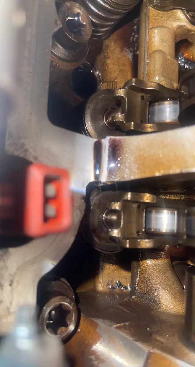

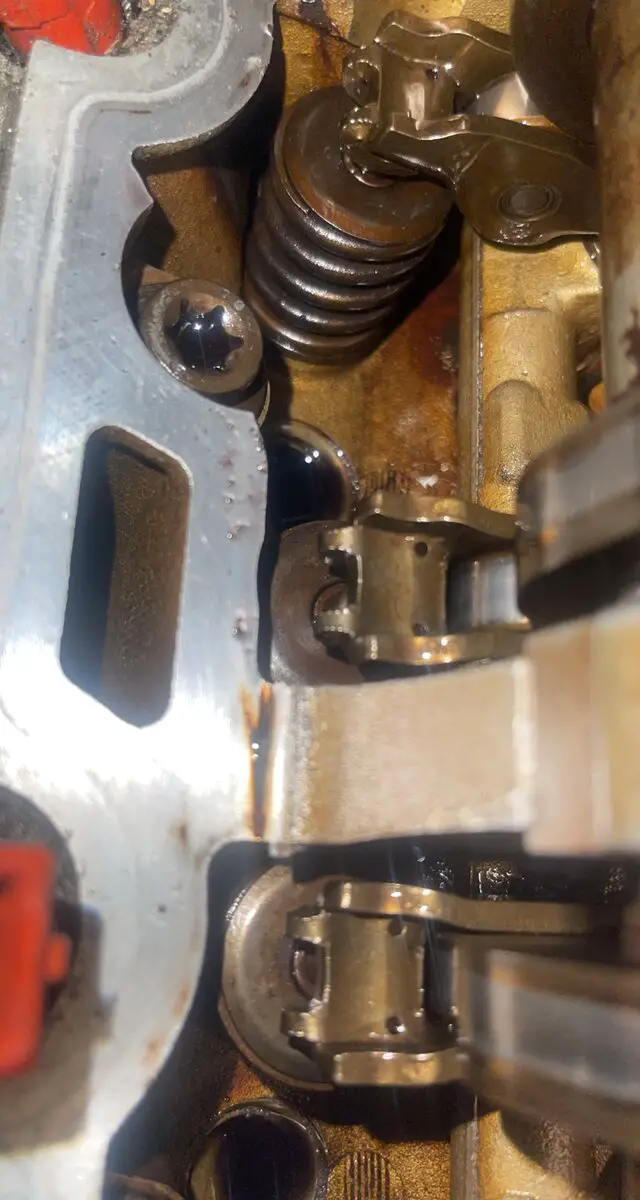

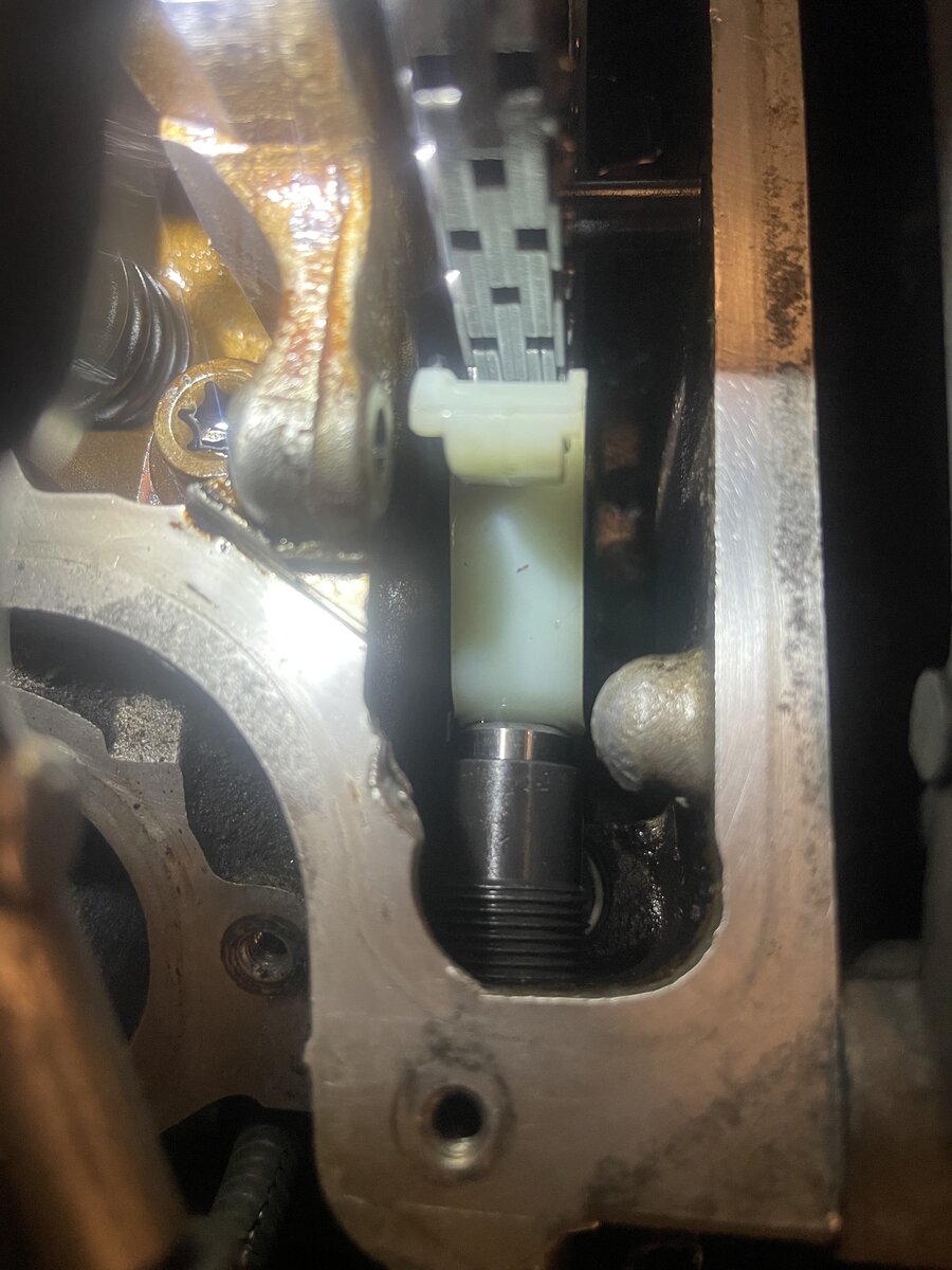

Ditto. The rubber vacuum elbow is no big deal other than that someone didn't notice it in there when the VC went back on. The valve keeper is a big deal, that's all that holds the spring and valve together. Hopefully nothing more is messed up, but the mention of other plastic parts of the timing chain guides is also very worrying. You might be able to put the valve keeper back in, but why did it come out. You need to inspect the valvetrain very carefully, the valve keeper may not be the easiest thing to fix.
