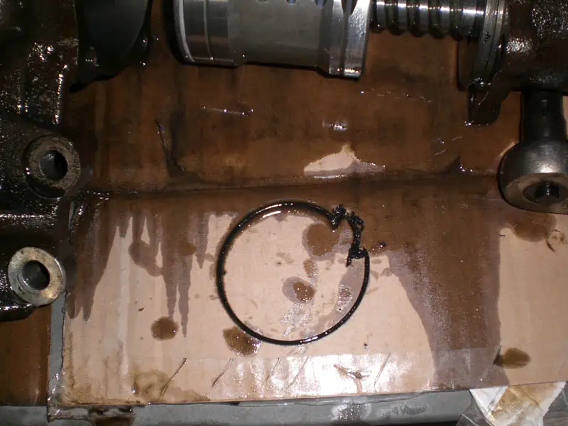

Kids gave me a second to tear the box off and apart tonight.
Good news: I found the problem. Something must have went wrong during re-assembly. :p:
Bad news: Will a bearing place be able to get an accurate measurement of this thing?? I'm thinking slim to none.
What do we think?
As an update - I finally just took the bad seal into a local bearing shop, and they had the seal on the shelf.
It's a 19x32x7MM rubber coated double lip oil seal - comes right off the shelf.
Did you happen to replace the input shaft housing o-ring?
If that is an O-ring, then there's a good chance you'll be able to find one locally since O-rings are standardized. Maybe search up Google on the exact number or at least dimensions on the replacement O-ring so you'll have some knowledge when you hit the stores.
The bearing shop can get you a SAE o-ring; that's a metric one, and it will be real close.
I destroyed one too.
I guess if all else fails, maybe a Toyota dealer might have a rebuild kit or at least the O-ring on hand.
Talked to my hydraulics guy (Pa). He's taking it into the shop to set me up on Thursday. :thumbsup:
The Toyota rebuild kit is $108. The o-ring I need is $0.48. :(
But for future reference: My rough measurements of said o-ring are OD - 2.75", ID - 2.60", Cross Section - 0.11"
I'll update with the actual o-ring we use.

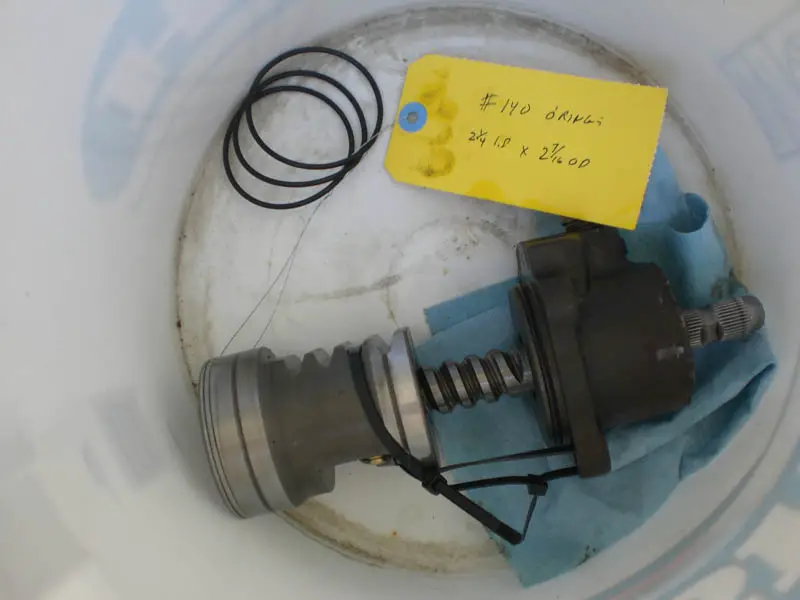

For future reference:
Here is the o-ring size for the input shaft housing of an FJ60 (and probably IFS?) steering box.
#140
2 1/4" ID
2 7/16" OD
3/32" Cross Section

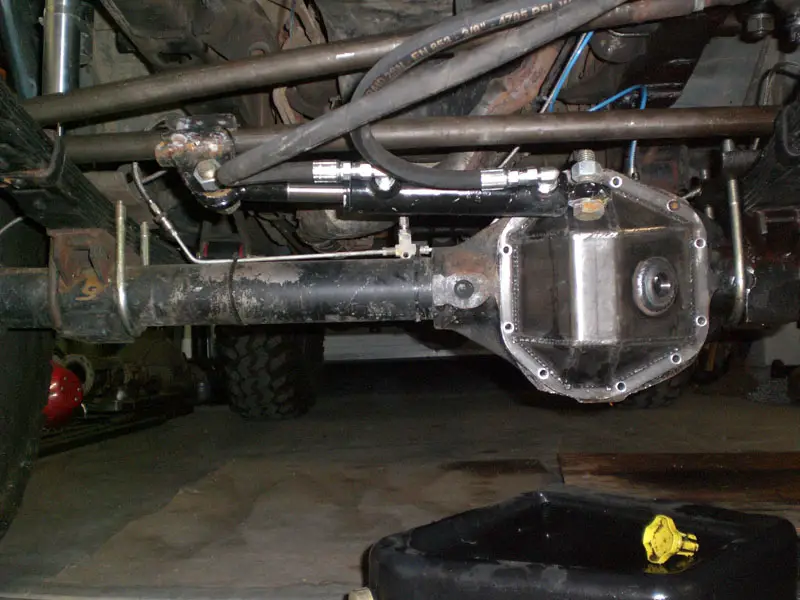

Here is how far I got today. I just have to fit a couple tabs on the cover, maybe make some pretty gussets with speed holes and such, then do a little rehabilitation to my tie rod clamp (it was under water for two years).. and this project will be checked off.
Tabs are in and its running. Seems to be working great from the little test drive I took it on. Still haven't but the shock on the driver's side (or oil in the diff for that matter). But all seems to be working.
Next time, don't angle the diff tabs too far to the passenger side. My bracket is just about as close as you can get to the leaf springs. If the wheels were turned all the way that direction I wouldn't be able to pull four of the six bolts off the tie rod clamp.
