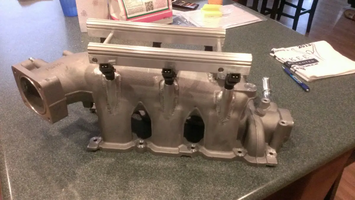

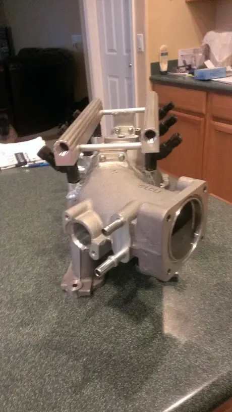

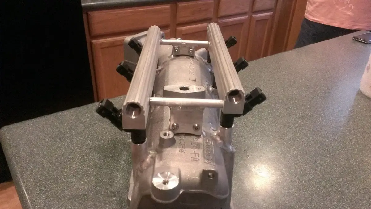

Auxillary fuel injectors - I bought a spare intake manifold off ebay from Rousch Yates, must be a take off from one of their ALMS motors they are building. The intake is at the shop of Bryon Pryde who is a master in fuel injector for the injectors and fuel rails to be fabbed up, should be done in a week or so.

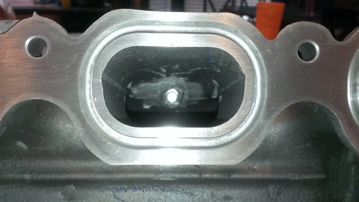

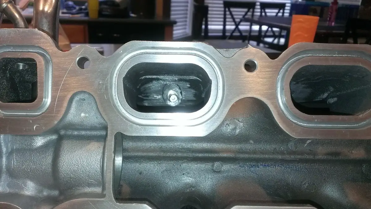

Auxillary injectors in the intake manifold getting close to completion:
