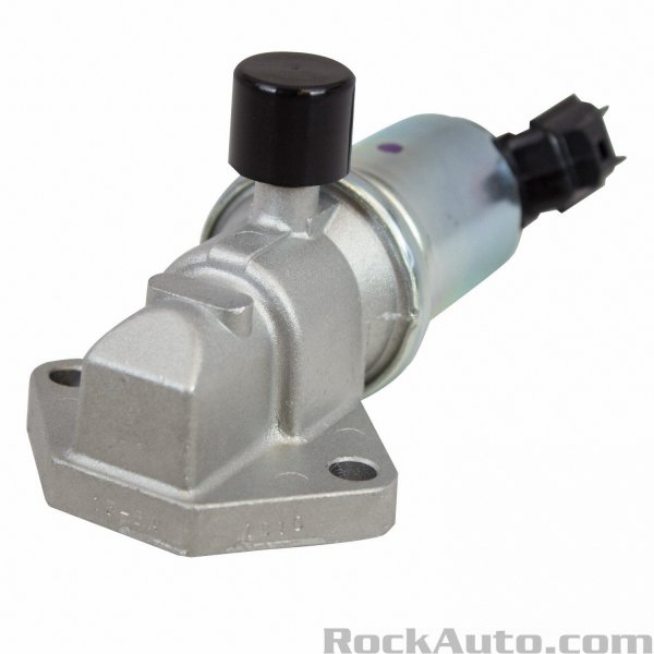

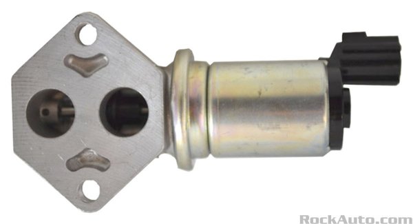

Codes read lean air and multiple misfire, but they have since I bought the vehicle(2005 with 60k miles). Cleaned the MAF about 8 months ago, cleaned the IAC(the one that does not disassemble I think), sprayed everything down with carb cleaner while running to check for vacuum leaks. Had a vacuum hose replaced 6 months or so ago. Haven't checked the PCV valve yet, that is next on the list I suppose.

The MAF cleaning, IAC cleaning, were videos I watched on YouTube. The vacuum hose was replaced by a mechanic. After looking at it recently, the mechanic couldn't tell me what was wrong, but said start with a tune up and we'll go from there. I apologize if this issue has been addressed on these forums already, I couldn't find anything like it, and thank you guys in advance for any help or suggestions you might have.
