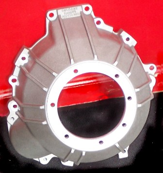

There would have to be either a custom Bellhousing made or an adaptor.

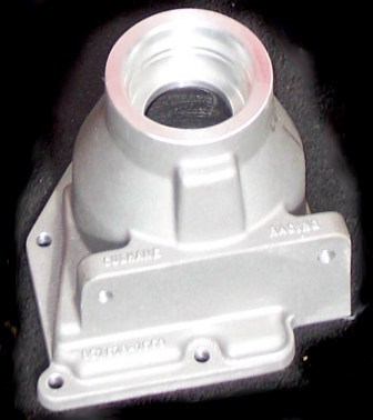

During my search I did find this. The problem is you loose overdrive but you wouldn't have to worry much about a built C4, and there are torque convertors for it.

A 4r70 won't bolt to your truck! You will have to have the bellhousing machined off and and go to an adapted bellhousing. Not only that the 4R70/aod-e will absorb around 25-35hp more than the tranny you are using. The 5R's only absorb around 1-2 hp over a manual!
You will lose 2 gears and lockup, why do you think the 4.0L is so lethal? It never drops too many rpm. It is always in the powerband. If you convert to a 5R55S, all I can say is bless you man! I still have issues with mine. I am in the process of another build currently! The trans is on temporary hold. Basically I just drive it, go to the track on the weekend.-j
