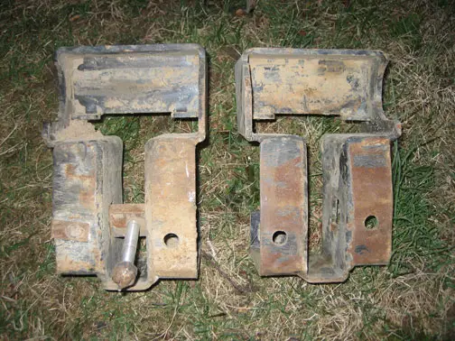

Here is a picture of the Superlift drop brackets:
In this photo, the brackets are UPSIDE DOWN - you're seeing the recess for the 98+ style isolator.
After you put the new pad into the bracket, it will look like the 98+ frame mount, just 4" lower:
No cutting, grinding, welding, religious ceremonies are needed to install the brackets. Just bolts.
omg this is such a relief, i was stressin about all this extra stuff i was gonna need to buy, but now it just like i get those pads, and they drop right into the superlift brackets and im rollin! that is an actual ford part # right? because if i dont have to get them on that website i can get em for about ten bucks a piece...(i work at a stealership) lol
