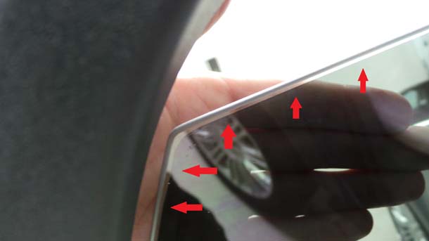

Yeah, not an Explorer, but also drive one, so why not ask for help? '94 Mustang GT I bought recently has window tint all scruffed from rubbing the inside rubber gasket.

Don't quite understand. I have no such gaps in tint anywhere, but have vertical scarfs from top to bottom from tint rubbing on the inner gasket. Can barely see through this result. imp

I had a friend with a VW Type III fastback. The tint shop he used warned about the rubber scraping the tint. They suggested just trimming the rubber with razor blade so it did not rub. Worked fine. Cut was super accurate, and not all wavy.
I have also heard about removal of the rubber that would scrape, and replacing it with some sort of felt backed rubber weatherstripping / gasket / belt moulding / window sweeps / whatever the correct term is...
It could be a good time to replace the window felts, new material doesn't damage the tint much at all.

Nice! Thanks. The real problem with the S-95 design over the Fox body is that the glass has no frame around it, so they squeeze rubber guides tight on either side to "stiffen" the glass position ensuring water seal at top and back, and maybe prevent window rattle. Felt would be a help, but not limit movement as effectively. Through-tinted glass would be a better thing! imp
