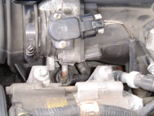

Ok, well, upon further review, the brass nozzle at the bottom of the TB is the canister purge hose...how do i remove this connector?
Why do you want to remove it? Pull the hose off your stock TB and put it on the new one.
It's not as easy as that...the not-so-flexible purge hose is factory-rusted on there and i cannot get it apart...not to mention that the nozzle on the new TB seems much smaller that the oem...take a look - right in the center of the pic at the bottom side of the TB and compare it to the brass colored nozzle in my first pic - this is what i'm talking about (not sure if your 94 is any different that my 96):

Remove all the other stuff, and remove the retaining clip on the hose. The metal part will not come out of the TB...it is one unit.Do a search for the part number but you have to buy a part from FORD that couples the vacuum part. You then stick this little plastic piece in the hose end so that you can put a small hose from the new TB to the vacuum hose. Try not to break the retaining clip when removing it . I did.
