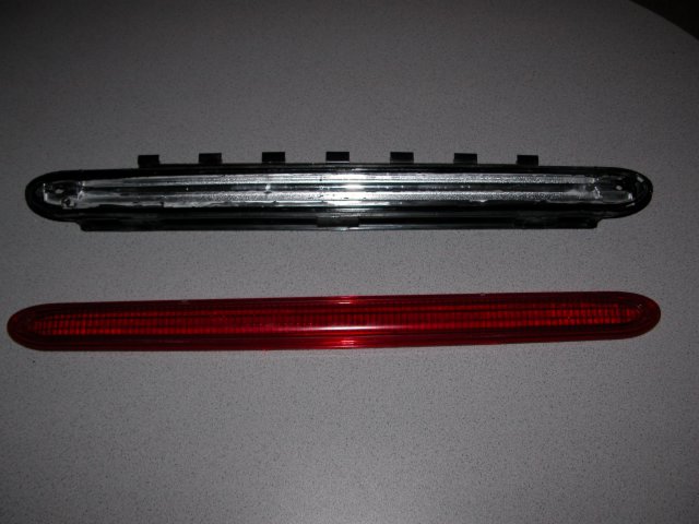

OK, I finally got tired of trying to figure out this stupid 21" neon high-mount brake light problem, and in the process ended up with two lamp assemblies. So, after searching for the best fix, I finally decided to gut one of the assemblies, and build by own LED array to put inside it. Here is what I did ....
  • After removing the assembly from the truck, and the lamp from the assembly, I baked the lamp in the oven at about 200-250 for 15-20 minutes, or just long enough to be able to "peal" off the lens. After doing that, removing the neon lamp, and cleaning it up, here is what I had.
  • Here is the assembly after being baked, and cleaned up, and the neon lamp removed, with some measurements shown:

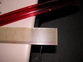

  • Next I found a piece of breadboard to mount the LEDs to. You can probably find something at Radio Shack, but you might have to make a two piece array, depending on the size you get, and how long you actually want your array to be. Notice in the image above that the assembly is about 3/4" tall, but since the back of the housing is curved, the array needs to be thinner than that so that it can fit comfortably down inside, so the lens does not hit the LEDs.
  • I cut the breadboard so that it would fit inside the housing. When doing this, measure carefully so that the breadboard will fit down inside the housing, otherwise the LEDs will touch the lens and you'll have trouble putting it back together. Learn from me - I had to do a lot of fine tuning to get everything assembled.
  • After determining how many LEDs I wanted, and how far apart they should be, I placed the leads through the breadboard and glued them in place. Be sure they are pushed down all the way, and are flat, or your LEDs won't line up perfectly, which is easy to see with these small viewing angle LEDs.

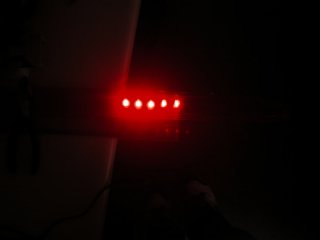

I used five 3 candela 10mm red LEDs, each with 820ohm 1/2w resistors. Total cost was $20, took about 4 hours to remove, bake the housing, and replace.
I wish I had doubled the number of LEDs in there, and they were a little brighter, but I cleaned out the store, and need to pass inspection tomorrow. I debated using 620 ohm resistors, but was worried about frying the leds at 14.5 volts. Looking back on it, the better solution would have been about ten, 10 candela LEDs. The 10mm "large" size seemed to work out well, they were easy to secure using hot glue.

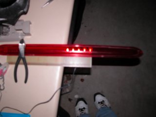

Finally started working on it.
OK, all sorts of excuses for being so slow. Work, been sick, had to go to China, etc. But I finally got started. Thought I'd build an array of 5 LEDs to test out the brightness, and mounting method. Here are some poor pictures giving a hint of what is to come when I'm finished.
First picture gives an idea if how they look behind the lens (but they actually look better than the picture). Second picture gives an idea of how bright they are with no flash. Third picture shows how they are mounted on a circuit board. I'll have to make the soldering permanent, glue them in, and cut down the circuit board to fit inside the housing, but that shouldn't take too long. I tried it with 5 LEDs, but plan to use 15. Should cover 2/3 to 3/4 of the assembly, so I think it will look pretty good.

Stupid Question. How do I get the light out of the truck and What is the heating to 250 deg for???
Thanks
Tim
There are about 5 rivets on the bottom side of the black trim piece. You open the glass to get to those. You have to drill those out. Then there are, I think, three nuts on the back of the light assembly. You get to those by opening the gate, and pealing back the trim, and removing the rubber plugs. Then there is a, what would you call it ... at snap nut?? on each side which you remove on the inside of the tailgate. After doing that, and disconnecting the 2 wires for the lamp, and the washer hose, you remove the whole assembly. The lamp assembly unclips from the black trim piece.
You then have to bake the assembly to soften the glue, and CAREFULLY take it apart to expose the neon bulb.

[foreward: I only know enough about electronics to be dangerous. I'm still learning about LEDs at the moment for another project]
Here's another thought (if it works): To save yourself a lot of wiring of the resistors to run everything in parallel, what if you wired up six or seven of them in series? (Assuming the lowering voltage is ~2V each) Then, if you wanted to, you could have two banks of seven wired in parallel, and no resistors in sight (and less heat from them, of course)
Unless LEDs in series act like light bulbs (i.e. the first one is brightest and they get dimmer on down the line).... In which case, ignore my ignorance.
What do you think?
-Joe
That's what I'm doing. I will have 15 LEDs, as 3 sets of 5 in series with a, I think, 220 ohm resistor. That pretty much gives maximum brightness, while protecting the LEDs. So I can adjust those 3 resistors if it turns out to be too bright. I'm now thinking that the ultimate design would be about 30 5 candella LEDs. I think it would look just like a factory job. Mine are going to be spread out a bit, as you can see in the photo, but I think it will look OK. Also have to glue them so they are straight, as their viewing angle isn't huge, so it shows very easily if they are not all perfectly straight.
