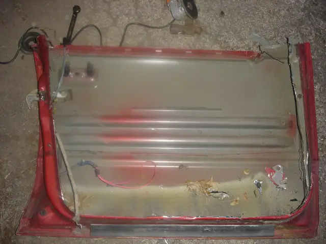

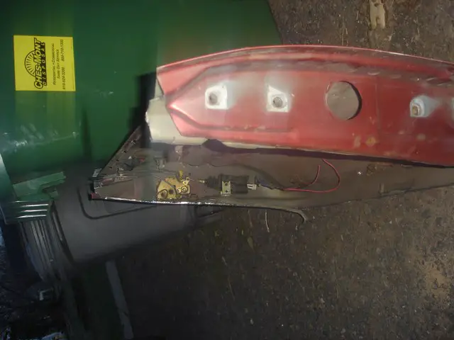

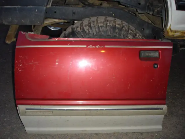

Ive always been envious of jeeps for their dang removable doors, so the time has come to make my own for the nice days. I had a set of doors laying around so I went ahead and cut out the guts. Im going to cut the outside from the upper hinge on an angle down untill its inline with the latch, if you can picture that. Im going to reskin the inside with aluminum or diamond plate or something and add some tubing or plate steel to reinforce the door, and make a sliding lever to open the door. Im going to cut the wires just inside by the parking brake pedal and splice in a new connector because the factory one is absolutly impossible to get to. I may also modify the hinges to allow the door to lift off/on. Even so, its only 2 bolts to take off the door as it is so its not to bad. Anways, its going to be a long prject, the hardest part will be getting the courage, and experience to do all the tiny little splices inside. Im also going to try and put in 2 speakers in each door, a nice mid and a tweeter aimed up.
Heres some naked door pics, more to follow.
