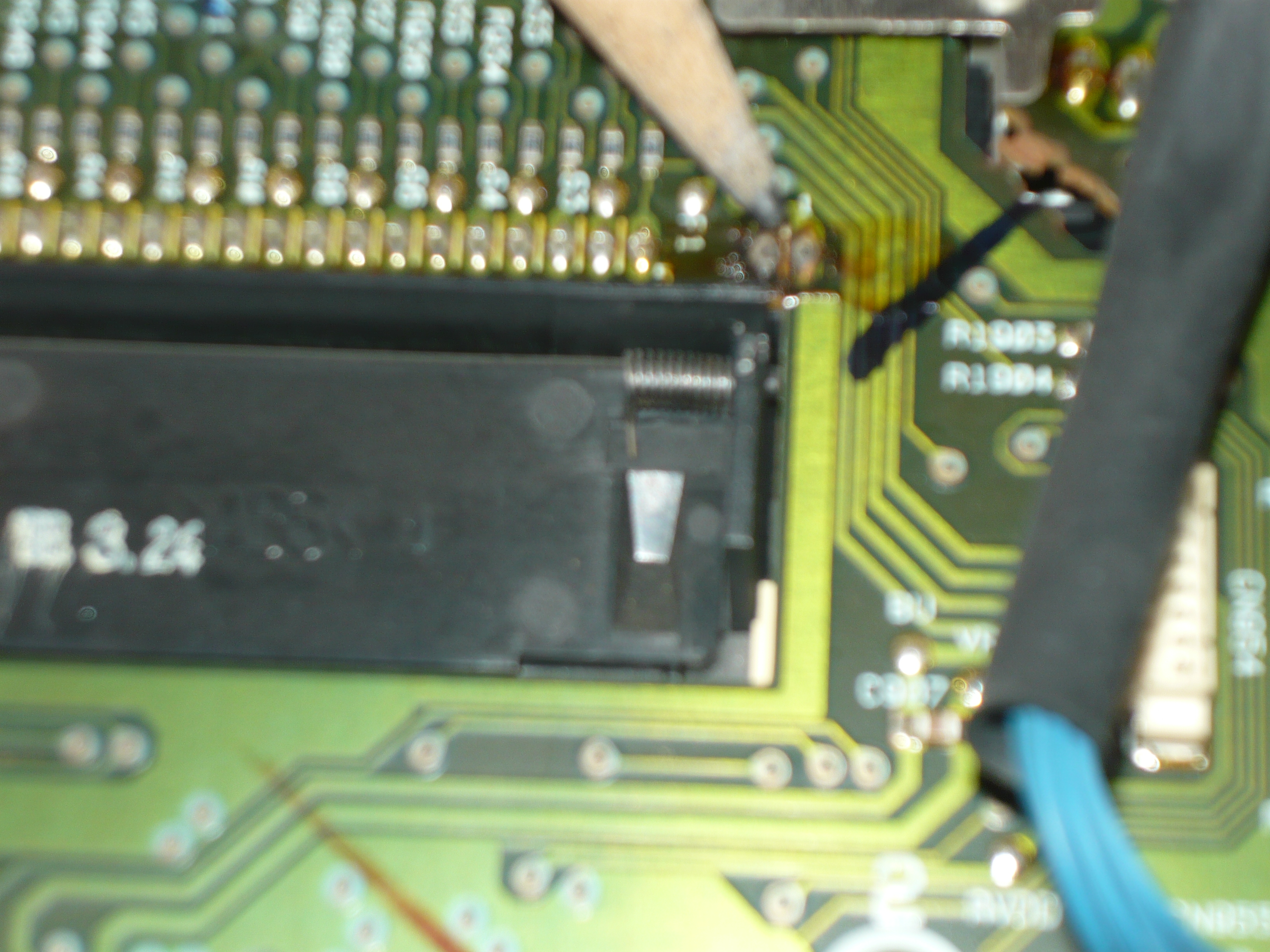

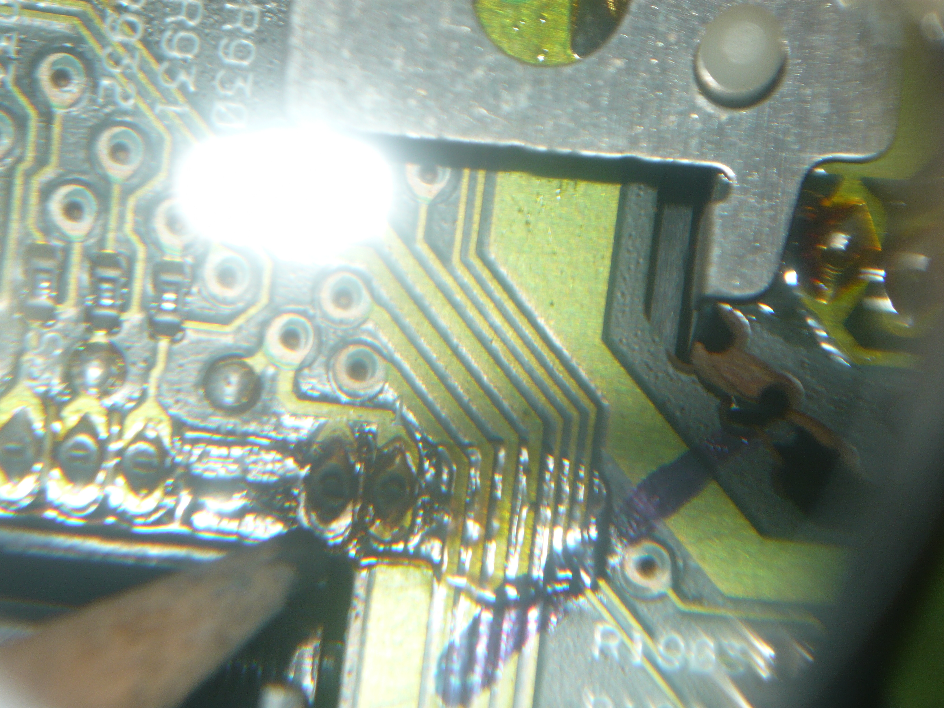

There's the key. Combined with info from the pic's you'll see a 2w resistor mounted to the opposite side of the board of the surface mount components
R1057/C1071/R1058/C1083/R1064.
Each leg of the resistor had about 1/4 inch (ok maybe less) sticking out of the board on the bottom. I'm imagining that the 2w resistor got too hot and heated those components up.
I'm hoping the quick fix of push those legs in (therefore moving the resistor away from the board) with the soldering iron is the key.
Mine is working now but we'll see what happens in the next few days.

i took the front cover off my radio like the post said. i look at all the joints. the ones coming out of the display were intact but had some browning on the board . on the display but the clock there was a discolored spot on the crystal. so i think its failed internally. if anybody has pics of before and after i'd like to see them so i have a better idea
thanks Matt
ow yeah two penny's fell out off radio when i took the cover off :eek: im sure that didn't help the problem

Mine came on today again for about 2 minutes (it was about 7* out) I went to set the clock and she went blank again as I was about to set the minutes
The first repair I made the day after I bought my 98 was the radio display. Since I have been an electronics tech and taught high reliability soldering it was not a tough job. The resistor dissapates a lot of heat and has a small solder pad and substrate for heat transfer. This magnifies any soldering defects. You really need to work under a magnifier. The solder joints on this board are not very high quality. The ones I have seen all had contamination and were not soldered at the correct temperature (cold joint). You need to clean the board first. I used radio shack flux remover. Next I removed the old solder and cleaned the resistor leads and pcb pads with a pencil eraser. Then placed a drop of liquid rosen flux on the leads and pads. I used silver bearing solder available at radio shack. This or eutectic 63/37 solder work the best. The eutectic solder has a narrow plastic temp range and so it is easier to prevent movement of the component leads. Movement of the leads while the solder is molten and cooling to the solidification point causes a frosted looking weak joint. Then I removed the solder from all components and cleaned, fluxed, and soldered them. That was 2 years ago and it has not failed yet. The problem is poor design practice and poor quality control. There is an old saying in solder land "the bigger the blob the better the job". This is meant as sarcasm by qualified techs. There should be just enough solder on the joint to form a well defined fillet.
A 12 volt 25mm square ball bearing muffin fan can be used as the previous post explained . I just searched and found one here.
