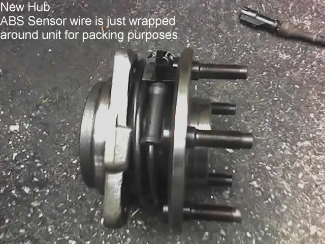

I purchased a DynaPak hub assembly from Advance Auto for $177. Seems to be a solid unit and I've heard from people in the past that have not had any problems with them. They do have a one year warranty against defects.
You should also purchase a new axle nut. They're not that expensive and since you're going to waste a lot of lactic-acid getting it off, you may as well put a new shiny one in its place.

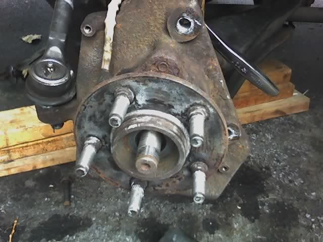

This is what you should now see:
8. Remove the 8mm bolt that holds the ABS Sensor wire to the back of the steering knuckle:

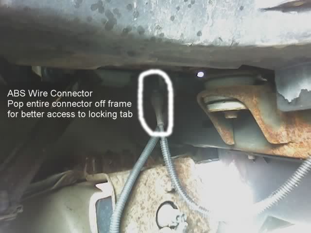

9. Disconnect the ABS Sensor wire quick-connect under the front bumper and any other clips securing this wire to the body:

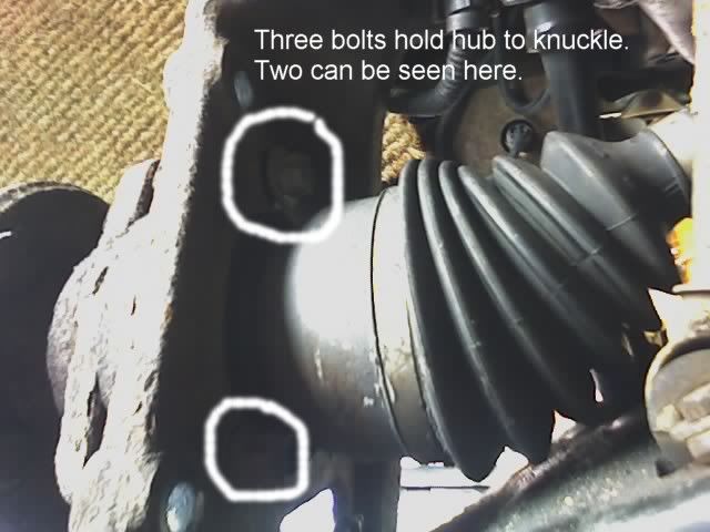

10. Remove the three 15mm bolts holding the hub assembly to the steering knuckle:
11. Hit the lug side of the hub with your rubber mallet a few times; it should break free. Then it just slides off the axle splines and into your hands.

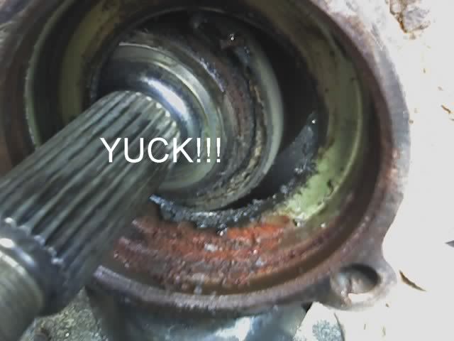

You should now see this:
Notice the huge amount of rust, fried grease and debris that was in the hub/bearing aperture.
12. Thoroughly clean and inspect the axle splines and hub/bearing aperture. Use a degreaser spray if necessary. Lay a film of anti-seize along the mating surfaces of the aperture and center flange of the axle.

14. Connect ABS Sensor to connector. The DynaPak hub assembly comes with new retaining clips to hold the wire to the frame. This was a very nice feature of the unit. Simply pop out the old crappy clips and pop the new ones in.
