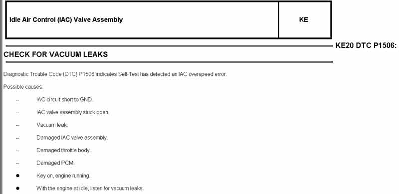

I have a MIL on, and a P1506 code. I searched the forum, and all I can seem to find are stalling issues related to the IAC and P1506 codes. Seems like the 'norm' is engine stalls flat out if you disconnect the IAC electrical connector.
Mine seems to be the opposite. When I start it, it revs high, and stays high for several seconds. If I give it gas (by hand, at the throttle body) it does the same. Revs high and stays high before settling down. If I unplug the IAC, it revs and settles immediately. It starts and idles smooth with the IAC unplugged. Seems like I have a LOT more power as well. I have driven it 2 days like that so far. Runs like a champ (except for the MIL light still on, this time shows IAC error along with P1506... wonder why? :rolleyes:)
Anyway, I bought the truck used, about a year ago. I've felt transmission problems every time I slow down to stop, since I bought it. That issue has GONE with the IAC disconnected. Perhaps it was messed from the day I bought it? Seems like it returned to idle WAY too slow, and though I was braking, the engine was still trying to run away.
Anybody ever hear of an IAC failing in this manner??? I ran through the service procedure, and the IAC measured 26 ohms. The spec is 6-13. I have a replcement IAC on order.

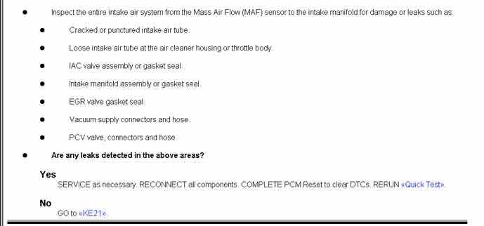

What's your idle speed with the IAC disconnected? It should be kinda low, less than the 750 - 830 rpm that is normal (warm engine, trans in P or N).
If its higher than that, I would look for a vacuum leak that is letting in extra unmetered air.
