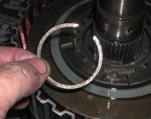

Thanks for the rebuild diary. It has helped a lot. I am down to the planetary gear and have been having a lot of problems trying to get the snap ring under the planetary gear to release. From the picture you show of the snap ring on the bearing it does not look like it holds the planetary gear to the case. Do you still have to press the input shaft/planetary gear out of the bearing ? I cant see how taking the snap ring off of the bearing is going to release the sun gear. Did i miss something? Please help.
That snap ring can be a pain. It does not hold the bearing in. I used two flat head screwdrivers to pry the snap ring open while pushing the input shaft jank down on a table. You are not opening the snap ring enough, it'll pop out easily when you do.
Well, after an hour of prying the snap ring apart i finally got the planetary gear to come out (yay), and now i understand how the snap ring retains the bearing under the planetary gear to the case. Man what a hassle but now i am starting to put the case back together again after replacing all the bearings. You were right, i wasn't prying the snap ring apart enough and even when you do it still may be a bitch. I found a small pair of surgical clamps helped tremendously as there really isnt much room to get a couple of screwdrivers into that space. Also if you cant find a large enough socket to drive the new bearing onto the shaft, a piece of exhaust pipe that is the same diameter of the inner race of the bearing works perfectly. I really appreciate the rebuild diary as i don't think i would have had the nerve to try this. Thanks.

Thanks IZWACK. And I will throw in my 2 cents... that snap ring is a HUGE PITA and requires patience, ingenuity and a willingness to open it WAY farther than you think ought to be necessary.

I'm trying to figure out a good method for removing these type of snap rings. Why can't they have holes in them so that snap ring pliers could be used? I've been prying at it for quite a while and haven't come anywhere near close to getting it off. What's the secret?
Well, I just got it off. 2 hours messing with it got me no where. But it only took about 5 minutes once I had an extra set of hands from a willing friend.
