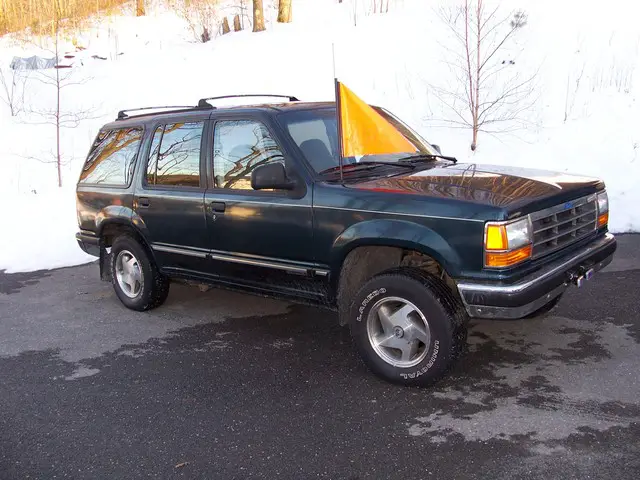

Alrighty. For this to be possible: first, you need one of these.
1, 1994 Ford Explorer XLT
