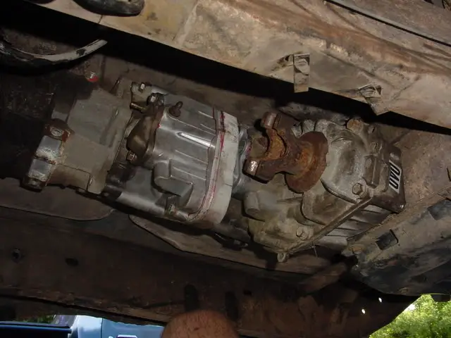

It can be done! Very tight but fits.

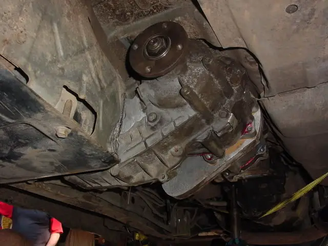

Not as bad as first thought on this side.

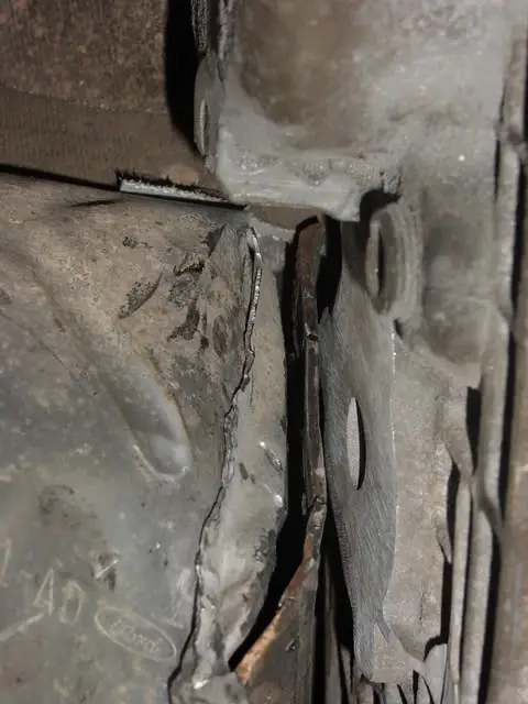

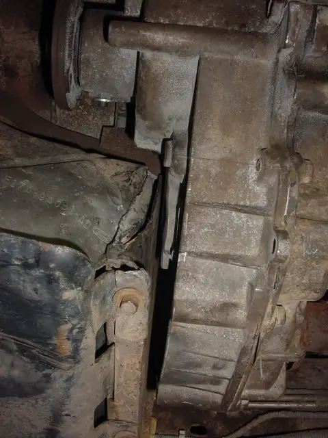

About 1/8" on this side.
This shot is not up at height. Just to show how I ground the back of the case.

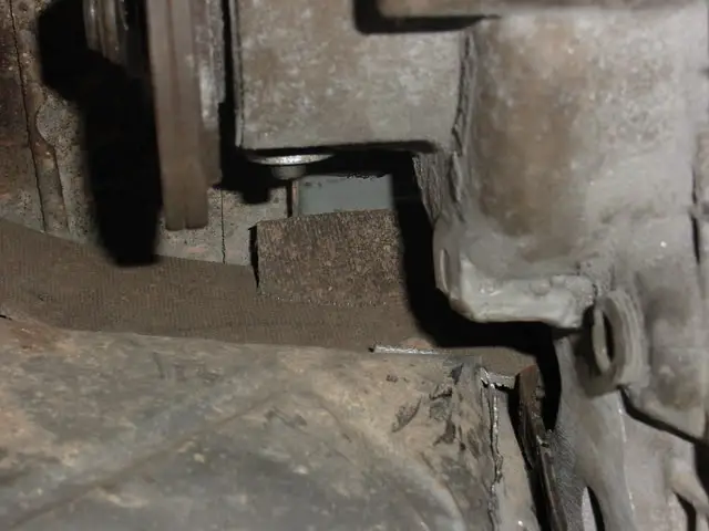

I don't know. If you really wanted a speedo, you might be able too. Go thru the rubber seal at the top but not sure if the cable is long enough.

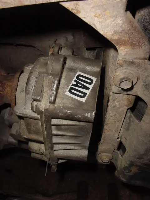

One last shot.
It's back out to be painted and filled. Now to build the xmember and the shifter.
