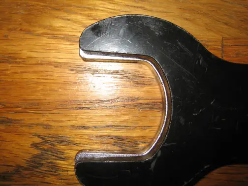

Found success at Pepboys of all places, where they had several "36mm" fan clutch wrenches for sale. I noticed that not all of them were the same size, so I purchased the "smallest" one, and what do you know, but I had my fan clutch off in less than 5 minutes.
Just so people know about this for the future:
Success: Pep Boys "Performance Tool" P/N: W80585
Measures out to a hair below 1 3/8" inches.
Failure: Autozone "OEM" P/N: 27018 (From their loan-a-tool program).
Measures out to 1 9/16" at the opening of the wrench, and tapers down to 1 1/2". This wasn't just the 1st wrench I rented, I went to a second Autozone and found the same thing.

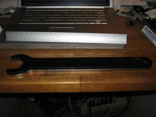

However, for holding the 4 nuts on the water pump pulley, I used the 72mm holder from the Autozone "OEM: P/N 27141 Loan-a-tool kit.

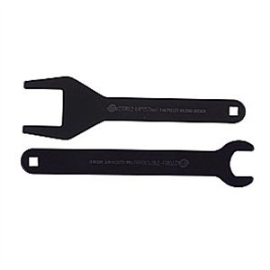

Photo 1 is a comparison of the two wrench heads
Photo 2 is of the wrenches
Photo 3 is of the pulley holder
