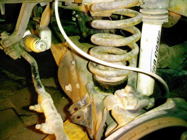

Oh I do I do:D But that was a long time ago. Now I'm using them to level or get 6" out of the skyjacker 6" springs which settle to 4 and1/2" or so i'm told. I also use the shackles with an aal in an Explorer spring pack and stock block in the rear for 6". At the time i was at 2" the Ex springs gave me 2-3". I was running 32x11.5 15 tsl radials on stock rims. I hab no clearence issues at all. sorry no pics then:( This the seat now.

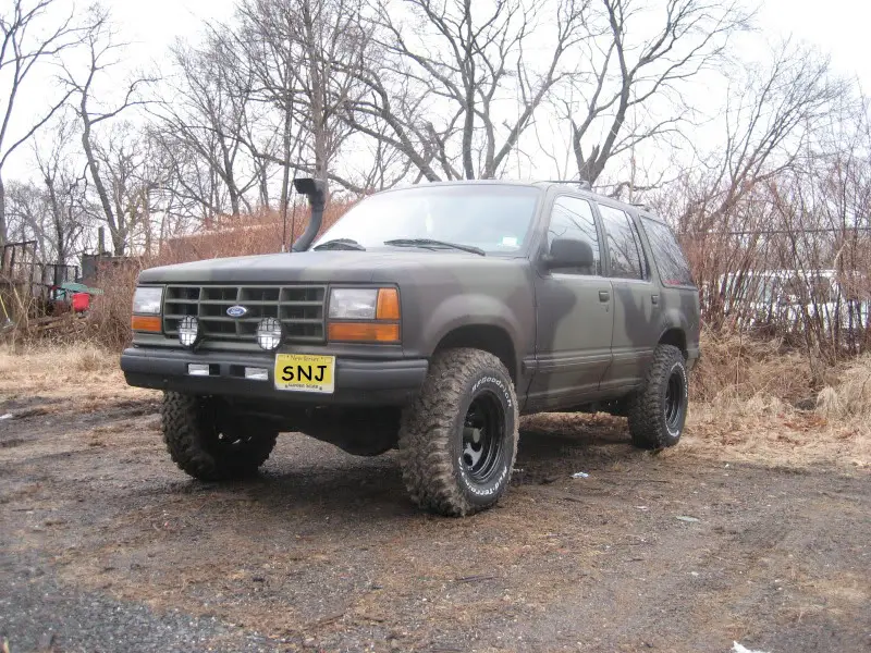

Here was mine before I started my SAS. It LOOKS higher than some I think. However, after cutting out the rockers and replacing them with my sliders I gained around 4" of body clearance (i think that's right...been awhile!). It's ok for mild-moderate trail/mainly street truck. You loose alittle down travel since you are still using the same old crap ttb springs but oh well.

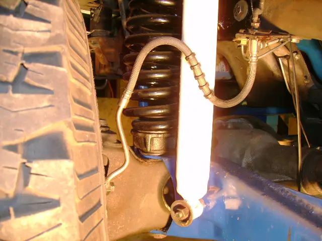

Before:

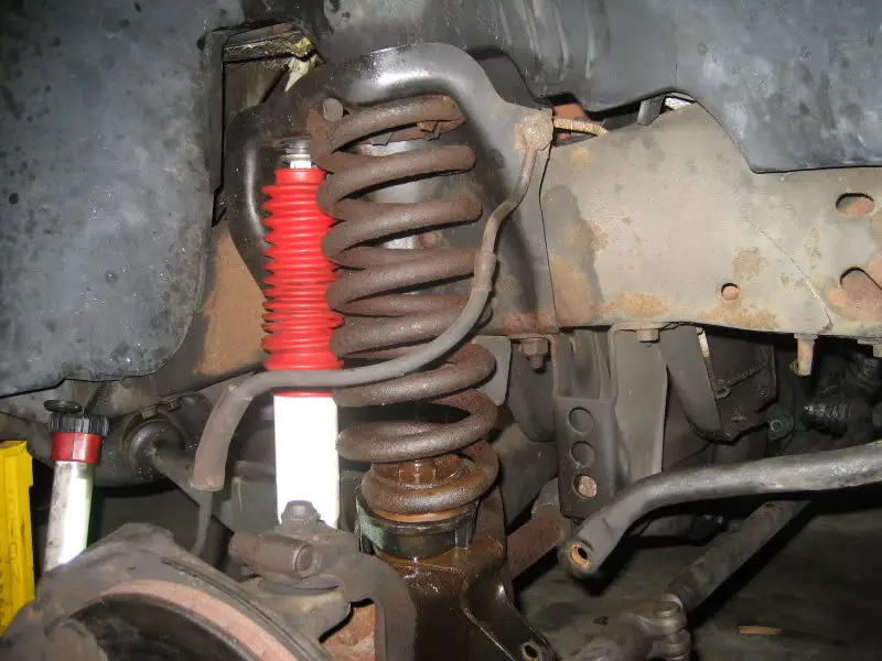

The difference betwee the explorer (left) and F150 (right) seat
Heres the seat in
after
Lift worked out real well while i had it. put a bunch of miles on it both street and trail before i decided to change things up again.

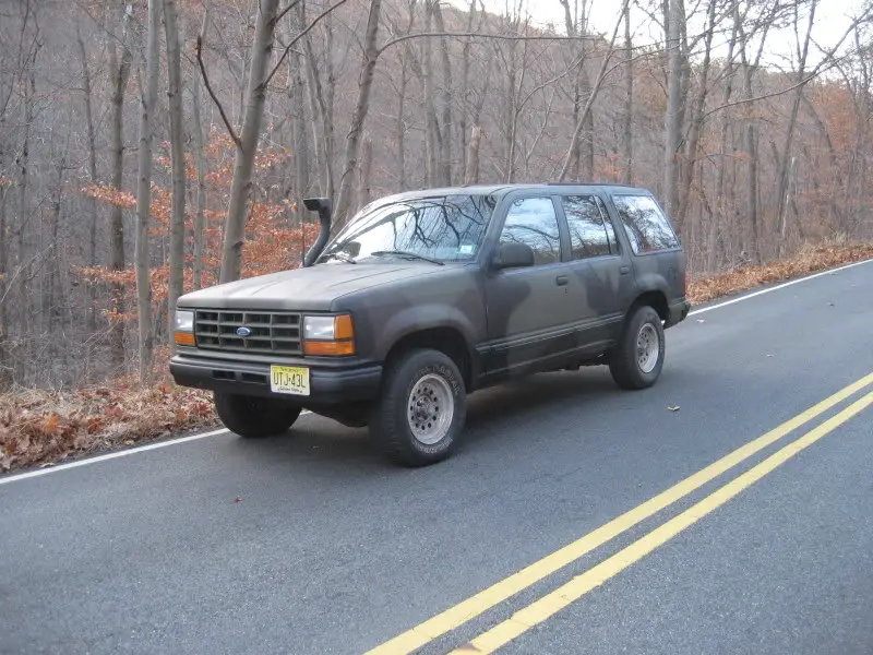

only took two years but what i had for a short time to prop up the sagging front end before i went to new Coils in the front.:p:
