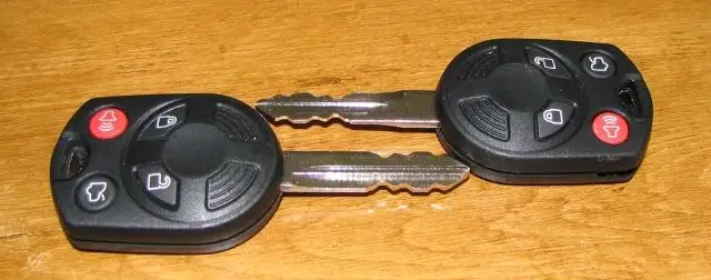

Got 2 on eBay for $80
They were for a 07-08 Fusion or Edge.
I have an 04 Explorer, should work for any 3rd gen.
Programming for both keys, remotes, and cutting was $80 because I only had one key to begin with.
If you have 2 keys already, you can program them yourself and save the $80 programming fee.
The locksmith hooked up his computer and it took 10 mins to program a second key for me. Then using the original and the newly programmed key, he programmed the 3rd new key.
All buttons on the new key/remotes work. The hatch even pops with the trunk button.
Ill put the original key and remote in a lock box for now as a spare.

with 2 existing keys, the programing is just a sequence of turning the ignition and switching all 3 keys. I dont specifically remember the sequence the locksmith did cause he did it so fast.
But I think the instructions are in your manual so you can do it for free.
Same with programming the keyless entry functions.
yea as long as u have two working keys ur good to go...
for the chip to program u put one working key in, turn it forward, take it out, put the second in, turn it, take it out, and put in ur new key and start up the car
for the buttons, turn a working key in the ignition 8 times forwards and backwards again... ur doors will lock and unlock... then push unlock on ur keys and turn the key backwards and pull it out... ur door locks should toggle again

Nope. The 3rd gens ignition dont have a collar around where the key goes in.
With your second gen, this key would not fit into the collar on the ignition.

so lemme get this straight, you buy the key from ebay, or wherever, then u take it somewhere to get cut, then if you hsve to keys you can prgram it yourself??? that simple?
Yip
If you have 2 keys, you can program yourself.
its that simple
I just bought a '05 EB- so far, I'm very happy with it. However, I only got 1 key. The guy at AutoZone told me that I have to go to the dealer for a second key, and it's like 150 - do I have any other options for replacement? I'd like to use the fusion key- that's pretty sweet...but without two already programmed keys that's a problem.
Sorry guys, I should have read the original post more carefully. I now see it cost him 80 bucks to have the locksmith program the keys. Still, I'd get 2 keys and FOBs for the price of one at the dealer....seems like a no-brainer.
