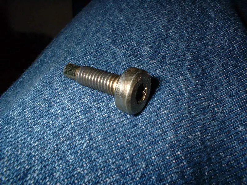

Quick story: I was driving home last night with my stereo up loud (it shakes the dash a lot) and a bolt fell from under the dash onto my foot. Today the shift lever for the transmission has a lot of free play and doesn't want to go all the way into "Park" and the needle doesn't line up with any of the letterers on the dash. I have to pull the lever towards me to get it to move down into "Drive" (actually OD). So, does anyone recognize this bolt as something that would cause my problems if it fell out? Or is this strictly co-incidental? The bolt is about an inch long.

You need to take your steering column and lower dash apart pronto
That bolt is a retainer for the shifter mechanism or something related to it
If you dont fix it you can break the shifter assembly then you are looking at big $$$ to fix it unless you go pull the parts from the junk yard yourself.
Not a huge ordeal but it does take some work to get back in there and fix.
I have seen alot of problems with the Gen II column shifters, breaking, wires for OD button break, the indicator out of adjustment, and worst case broken lever = need parts.
Worst case however you can drive the truck by pulling/pushing the cable with your hands :) LOL been there done that
Thanks, I'll leave it parked until I get time to fix it. It's a good thing you mentioned the severity of the problem, otherwise I would have kept driving it... only to cause more problems.
This was the easiest thing I've ever fixed on this Explorer. I was able to lay on the floor on my back and reach up in the dash and put the bolt back in with out taking anything apart. You have to be thin (scrawny) and very flexible to get at it though...

Ok, I layed down on my back, I met all the human built requirements, can't feel a dag on thing in there. Do I have to take the steering column off and lower dash as was said before? Mine is still in but there is lots of play in the shifter so I want to tighten it before it falls out
D a n a
shine a good lite up in there while your moving the shifter a little .you will soon see the area you need to be working in .only 2 star bolts your looking for.
Just fixed that two days ago on my 97 thanks to the guys on this forum. Layed on my back with a good light. There are two bolts like you have to hold the shift lever to the coluum rod. They are just above the steering shaft it self and about 15" up from the fire wall, So your head has to be planted under pretty good.
Had the same problem, I found the bolt in the floorboard. I figured out where it went and got the right tool to tighten it and handed it over the the misses. Yep the wife was able to do this fix due to her size and me just having shoulder surgery.
