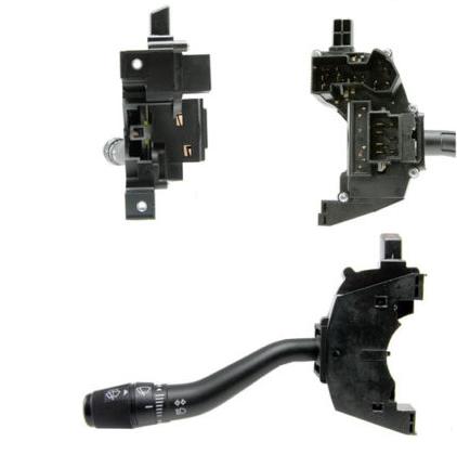

Hey guys, I seem to have the same problem on my truck since today... I lowered the steering column today (for my mother who needed to use the truck, as hers had a flat) and the turn signals + hazards stopped working altogether. No flashing, no light, nothing... The bulbs still work ok and the 15 amp fuse in the fuse box seems to be fine. Turn signals and hazards worked fine so far and never gave me any problems.
Where exactly do I have to look for the connector that might have come disconnected? I've read the previous post about the steering column, but then someone mentioned it being near the brake peddle..? It's really cold out there today and getting dark early, so I can't play the guessing game for too long without catching one of those bad colds, lol...
Any help would be greatly appreciated. Thanks in advance... :)
By the way, this is the multifunction switch we're talking about, right? Thanks...

Yes, thats the multifunction switch, and the connector you are looking for plugs into that, and is under the plastic steering column cover on the top.
Thanks! Upon conducting another inspection, I decided to put the steering wheel back in it's original/my driving position (pretty much all the way up)... and what do you know... the freakin turn signals/hazards are working once again, as if nothing ever happened. The plug must've slipped back in its' place. :eek:
