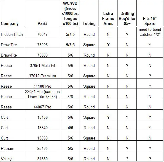

Below is a collection of stats for Class III and IV hitches that fit a 1999 Explorer (drilling is always required for '91-'94 Ex'es).
I am in search of a hitch that I can easily modify (i.e. not weld) so it doesn't look as unsightly with my 3" body lift. I have downloaded all of their Instructions to examine how they are built. Let me know if you want one posted. The only one that is "3-piece" is the Reese 37012. From the picture below, it looks like I can drill holes higher on the side brackets to lift the hitch. I can't tell how much higher, probably not 3", but even 1" would make a hitch with a body lift look much better.
What do you guys think?

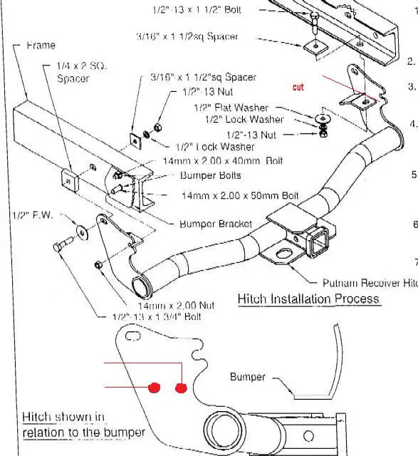

They do line up with the frame rails, but that horizontal tab goes right beneath the frame, so there shouldn't be anything in the way between that tab and the top of the square hitch tube, so it looks like I have that space to play with.
Below is the Round Draw-Tite to show how the hitches bolt to the frame:

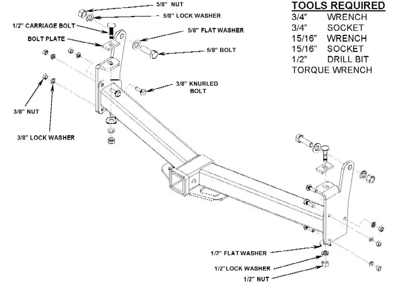

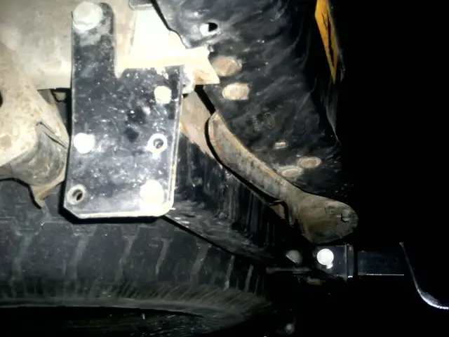

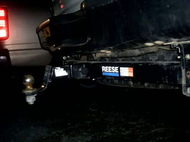

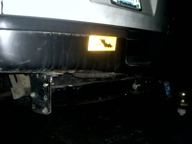

i have the Reese 37012 and just recently cut and drilled it to accomodate my 2"BL. 2" is about all you can get without cutting the 1/2" carriage bolt. that would only gain you 1/4-1/2"?? but it can be done and it looks 1000x better
also if your still looking for one in a month or two, i probably will sell mine when i fab up a pre-runner style bumper with a hitch built in. work is a major factor on that timeline though.
i can get you a pic if you would like
__________________
2"tt(soon to be history!), 4dr leafs, aal, shackles, 2" BL, 285 BFG's on stock "chrome", aussie rear, BWM, k&n drop in, $50 light bar, stealth 10" /amp/cobra 19, custom rear and front RLC winch bumper, warn m8000, roof basket
wisekise is offline   Reply With Quote
Old 01-11-2009, 09:02 PM   #11
BonesDT
Westchester, NY
BonesDT's Avatar
Red '99 Sport SOHC 4x4
Join Date: Jul 2002
Posts: 1,085
Vehicle Specs
(Original Poster)
I would love a pic, thanks. I'd like to see the redrill and cut and also the way the square tube looks under the bumper from afar. I'll take a cold beer too while you're at it.
2 months is about the max I could wait, so I'm interested up to that point. Keep me updated.
__________________
Mazda M5OD-R1HD, Ranger FX4 shifter, BorgWarner 13-54 M, Aussie Locker rear, PA 3" body lift, 2" TT, Warrior shackles, hybrid leafs, Monroe Reflex, Goodyear DuraTrac 33x12.5x15, AR Mojave Teflon 15x8, Flowmaster Dual 40 Originals -> 50 SUV, Power Slot Cryo, Hawk LTS, Smittybilt Outland grille guard, APC clear lenses, Mustang FR500 steering wheel with Cobra airbag, Kenwood DNX9140, Valentine One, Dynamat Xtreme, Autel MaxiDiag US703
1989 Shelby Dakota Convertible 5-Speed under restoration
BonesDT is offline   Reply With Quote
Old 01-11-2009, 09:45 PM   #12
wisekise
Elite Voltage Junkie
kentucky
wisekise's Avatar
1998 sport
Join Date: Aug 2007
Posts: 489
Vehicle Specs
pics, no beer here...only bourbon!
crappy pics, its dark out
i snapped a bolt re-installing it, so the oddball is a grade 5 temp fix
also the bumper has metal hanging down with holes ( for chains when using the bumper ball mount??) that would have to be cut as well as the carriage bolts
and yes thats a 285/75 spare, that took some cutting as well

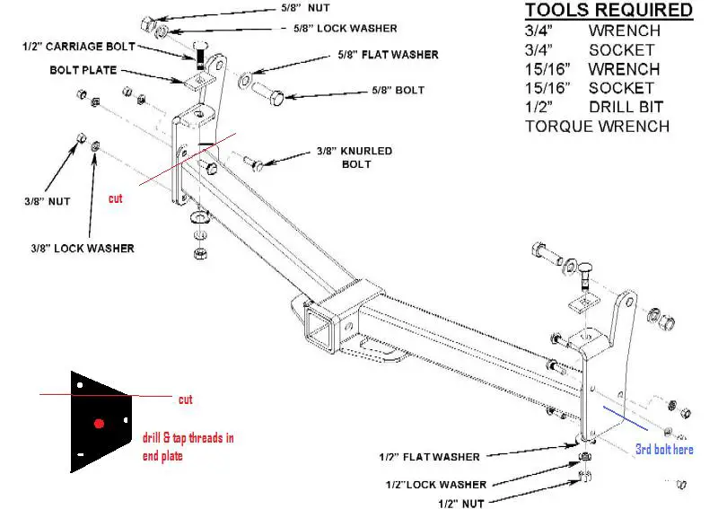

Now I have to ask you a question. When you take the side brackets off the square tube, are the ends of the square tube closed off or open (you can see inside the tube)?
If they are closed off, then it looks like you can maybe gain about another inch if you scrap that top bolt, shave off it's hole so it's flush with the top of the square tube, then shoot the third bolt from the other side, right into the middle of the tube.
The only problem is, you couldn't get a nut on the other side, so you would have to rely on tapping and threading that end cap plate, but it looks like it's thick enough plate for it.

yes the plate covers the tube. i think the plate is 1/8or 3/16". the bolt you used would have to have a really fine thread for that thickness IMO. the shackles have about 1/2" before they hit the hitch and i have never flexed and hit it and i've had'em stuffed. with the warriors i think you would have less a chance. i thought that too when i made a set of shackles(too busy to install) but most people on here say that it wont affect them when flexing

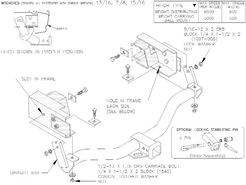

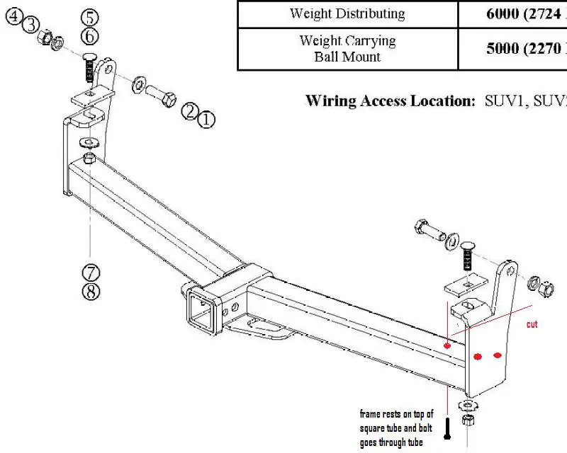

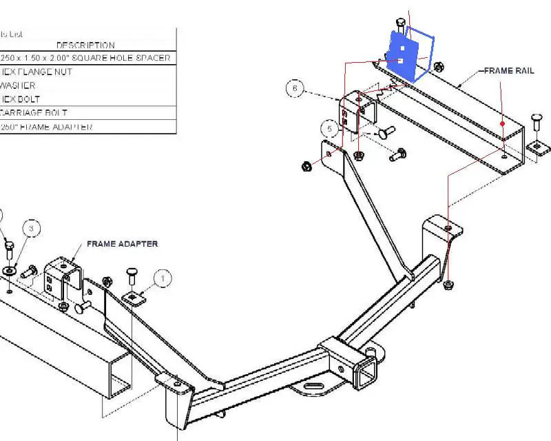

I'm getting carried away. I found 4 more hitches that could work with minimal modification.
The first pic is the Curt 13106. It's also exactly the same for the Draw-Tite 75096. This would work perfectly if the frame is 3" thick and there is enough room in the back to put that bracket on top of the frame. I'm going to check it out and measure. I like this option the best so far, because it requires no mods to the hitch (resale no problem) and you get the benefit of the heavy-duty long-arm hitches.
The second pic is the Reese 44100 and the third is the Putnam 25185.
