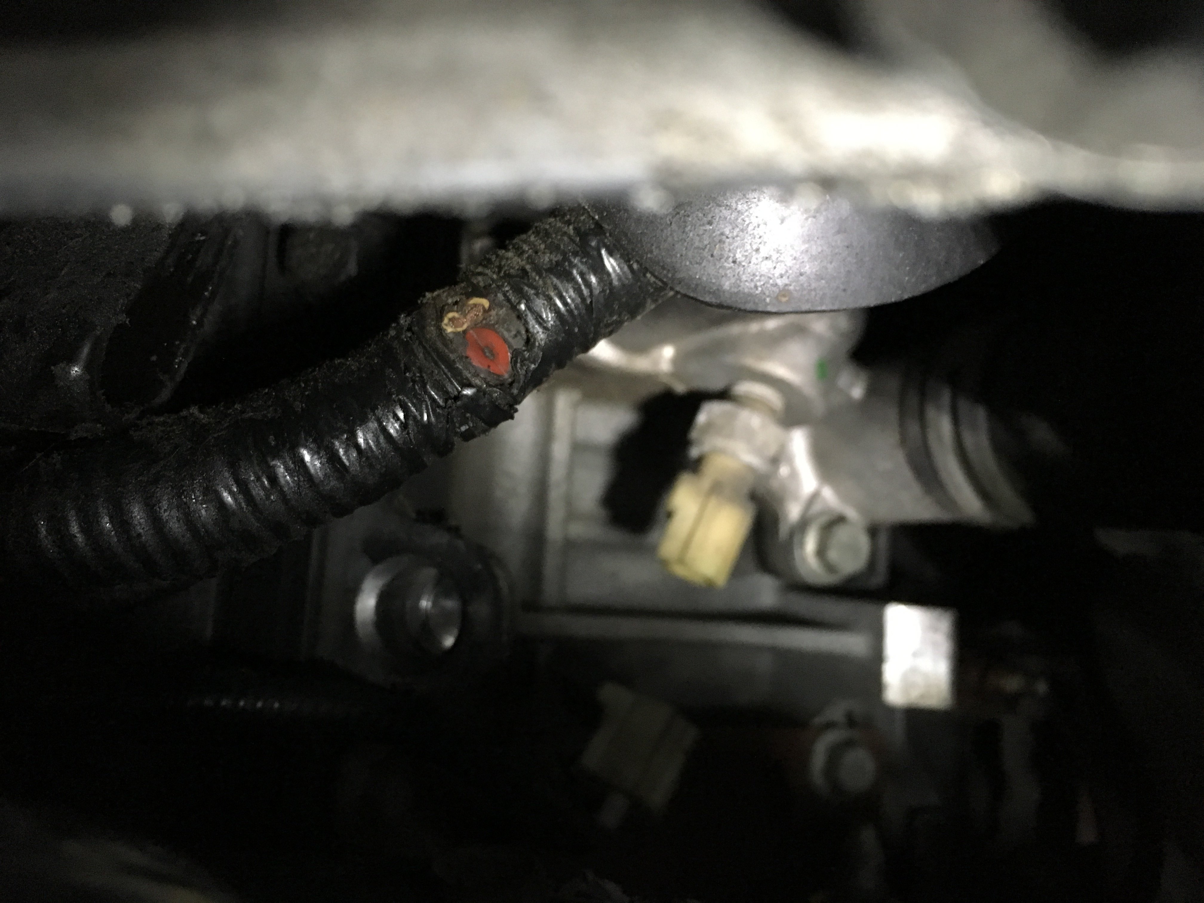

Also, check the wiring harness on the front crossmember. on my 02 v8, the little guard for the oil filter to keep it from draining on the crossmember wore thru a wiring harness right behind it. randomly the oil pressure gauge would drop, then come back up when i revved it. the little guard had cut the wire for oil pressure about 90 percent thru, so when i revved it vibrations would make a crappy connection. if its busted throw the guard away like i did, pull back the sheath on the wire harness, and splice the broken wire back together.

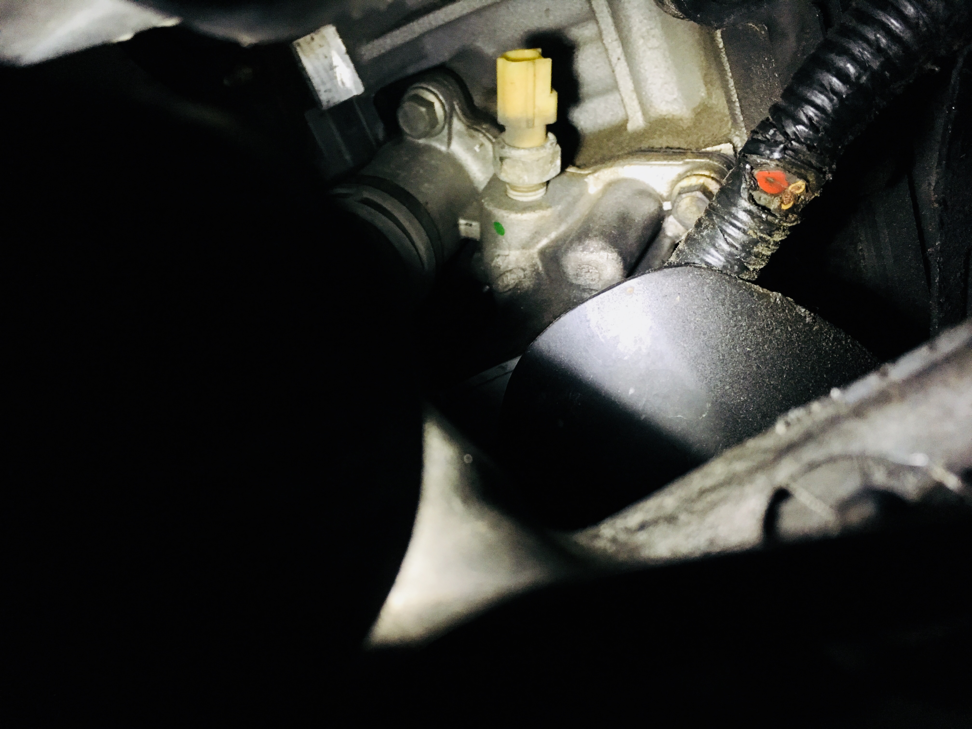

Reviving this Post! My 03’ 4.6 Eddie started throwing the Hi Temp Low Oil at idle and the oil pressure gauge dropped to needle rest. Rev it up and it goes away and the oil pressure gauge reads normal. FourXFred made an amazing recommendation and saved me a ton of time! Found my oil pressure sensor wire nearly severed in half. The job to repair it isn’t bad.
Here’s how to fix it:
Step 1: Disconnect the Positive Terminal on the Battery
Step 2: Remove A/C Compressor Connector. It is also clipped into a retainer shared by the loom leading to the passenger wire loom for the injectors.
Step 3: Disconnect the starter main cable and solenoid wire using a 13mm and 10mm wrench respectively.
Step 4: Using a flat head screw driver separate the cable retainer on the center cross-member and remove the starter loom from the retainer bracket.
Step 5: Disconnect the oil pressure sensor switch connector.
Step 6: Remove the two nuts under the power steering pump that attach the loom bracket to the pump using a 13mm deep well socket and extension. These are accessed via the driver’s side wheel well in front of the tire. (Note a ground cable is also attached and must be reinstalled!!!)
Step 7: Pull the entire starter-A/C-Oil Pressure Sensor loom up and out next to the battery.
Step 8: Repair the severed wire. I cut open the loom, soldered the wire back together, heat shrinked it, re-loomed it and wrapped it in 27 layers of electrical tape.
Step 9: Re-install the loom in the reverse order. I also routed the loom around the back side of the oil filter drain plastic...I like to fix things just once!
The job took me about an hour, but I was a Ford mechanic in a previous life. If you have access to a lift I highly recommend it as it will make even shorter work of the job. Good Luck!
