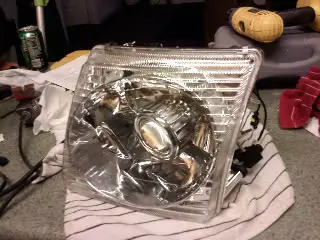

just got in the my new headlights i will take pics and of how they turn out

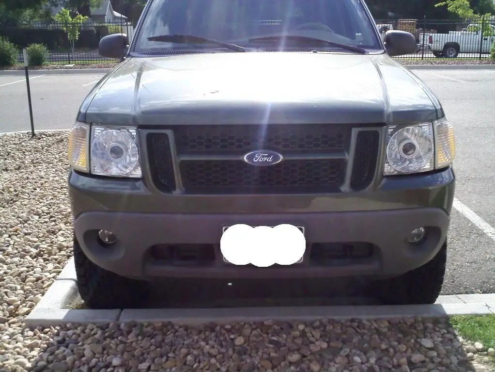

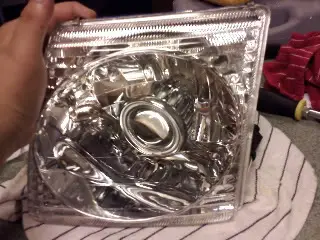

alright i finally go them put together what do you think
ya there not to bad i just go tired of being flashed by on coming traffic with the hids in the headlamp the light is to scattered in these headlamps cant wait to see what kinda beam they lay down

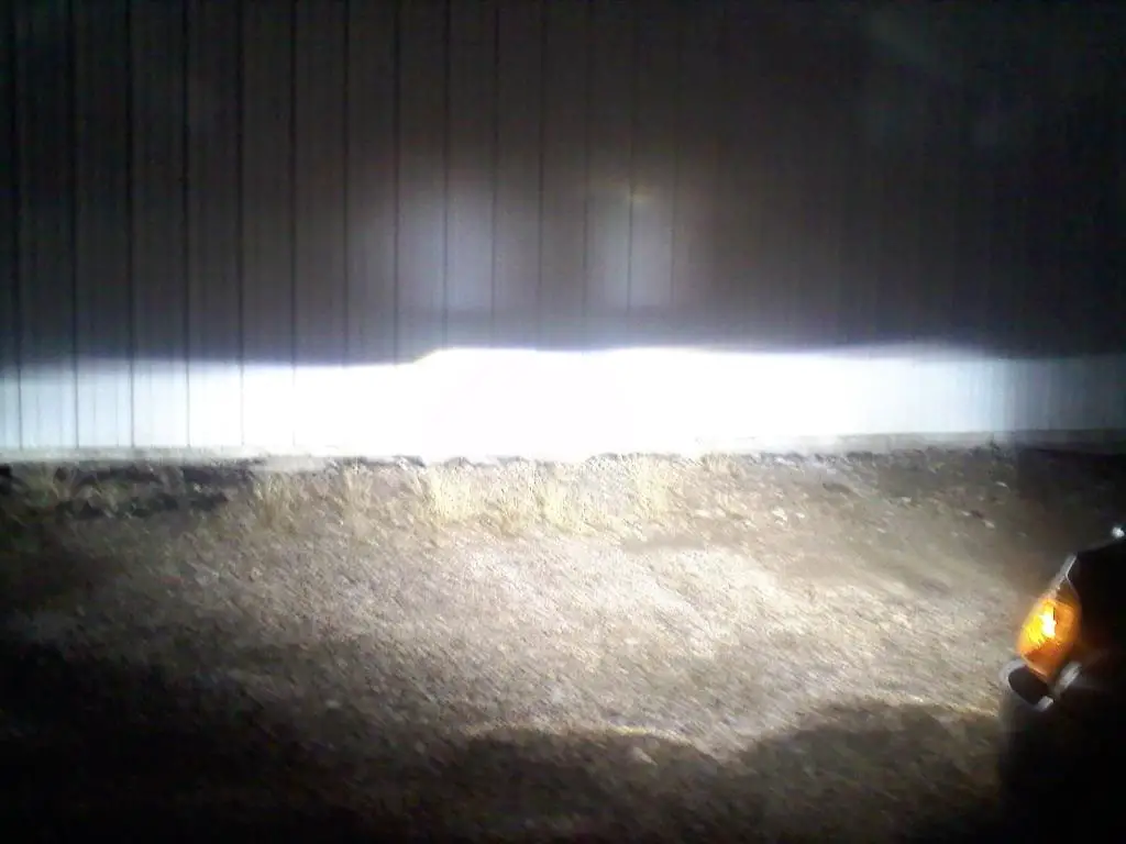

here are some pics they arent the best but for spending $99 on the projectors and another $50 on the headlights i think it is worth is. they are not the best projectors in the world but there is no glare and the light output is good to
lows
highs
and for the install the only hard part was taking the headlights apart but other than that there was no other modification to get the kit to fit it was plug and play. i have not hooked up the halos yet not sure if i want to at this point yet. all i can say is was worth the price it was better that paying a kit that i would really have to modify to fit let alone the cost for some of those kits around $300 at least for new
all you do is take the headlight lense of the headlamp. and then just stick the projector end through the light bulb hole then there is an adaptor that aligns the projector in the hole from outside with those little notches that the 9007 bulb uses to align in the houseing and finally put on the supplied lockwasher and oversided wing nut. then put lense back on headlamp and so on
