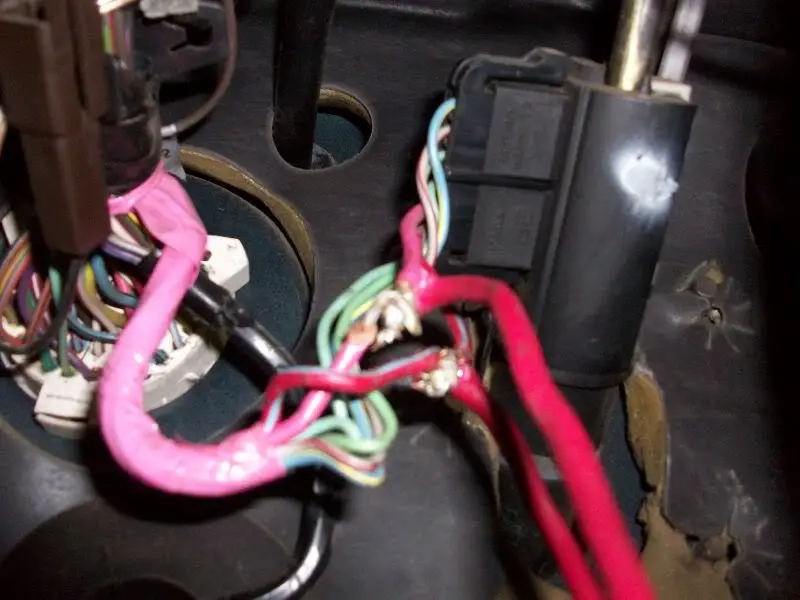

I finally cleared out all the unneeded and horribly done wiring for the lights and cb. I also replaced both battery terminals with a set of boss audio terminals and bought a "poor man's odyssey", a sears die hard platinum battery.

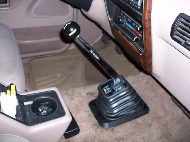

This thing desperately needs the hurst shifter kit put in it, it takes forever to find first gear and it feels like i'm driving a semi truck shifting gears. the worn bushings and me being a portly fellow prompted me to trade in the dual drink holder out for the single. I bet i'll fall more in love with the 4.0L than I already am with a lot firmer shifts.

I finally scrounged up some extra dough and got this kit. the old stuff was pretty torn up. right after I pulled it out and away it just imploded and shat everything into a few pieces. I eyeballed the shifter length and I added that spacer that comes with the kit to have it sit right. it took longer to trim the boot for a good fit with the factory ring than it did to install the mechanism itself. the only gripe I have is that it does transfer a lot of noise into the cab, I can hear the tranny gears whine in every gear a lot louder than it did before. I have read about it from almost everyone who put one of these in and I thought that they were being too sensitive about noise but I was wrong. I also have on the way a set of center caps for the wheels, I have to cut the holes for the hubs in two of them though. I also came up with this idea for a set of shackles:

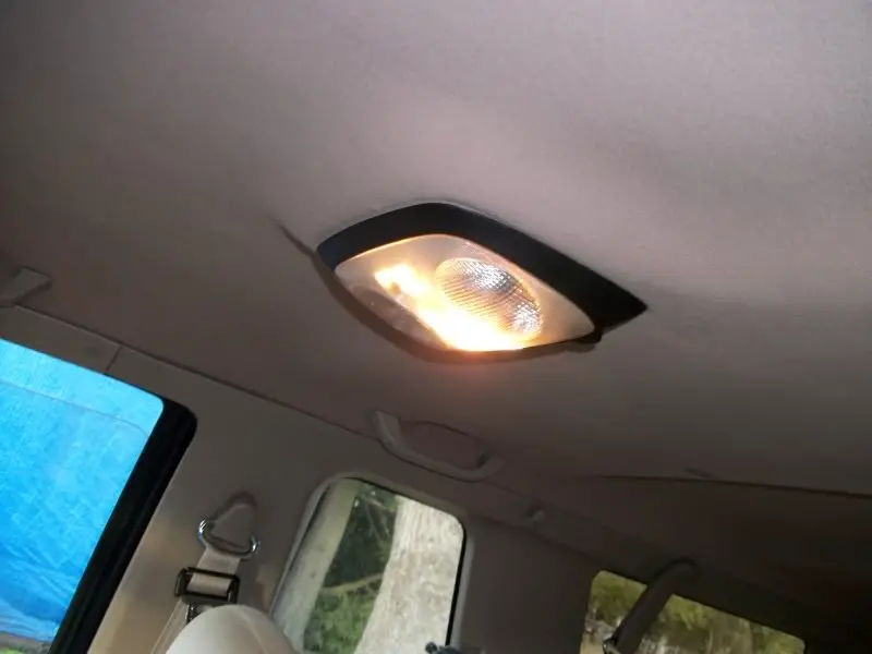

the OHC was grey and the overhead light was tan so I painted them black to match and add some contrast.

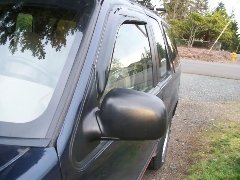

Picked up some 96 mountaineer mirrors and some vent visors off ebay ($30) for the rainy days. before I put them on I painted the black parts on the doors and the rear hatch cause they faded pretty badly as you can see.

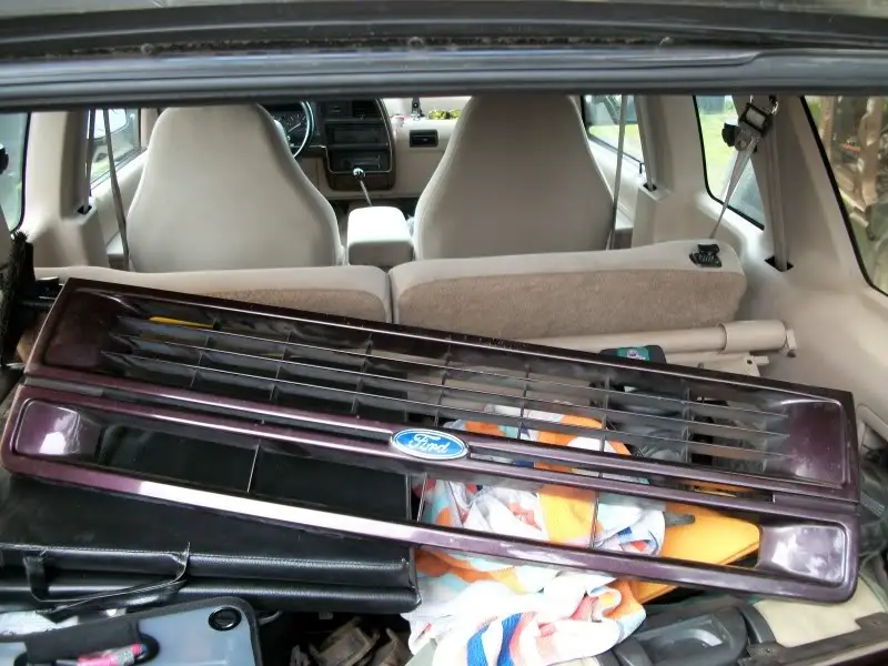

Got some new stuff, so ill update this again. I bought a pioneer premier DEH510UB, which is now being discontinued by pioneer cause they're dropping the premier line. It got dual USB inputs, an AUX input, front, rear and sub high power pre-outs, remote and OEL display. its too bad these aren't being continued on, cause its a really nice and buildable deck. I also finally got an explorer limited grille that wasn't damaged in the local pull-a-part, I also got the driver corner trim piece cause mine is broken, the blue lens and the wiring from the OHC it had(mostly broken). I also got some factory ford f150 coil spacers off a TRS user, and I bought a piece of 2"x2" box steel to put in as a support for the shackles i'm making.
