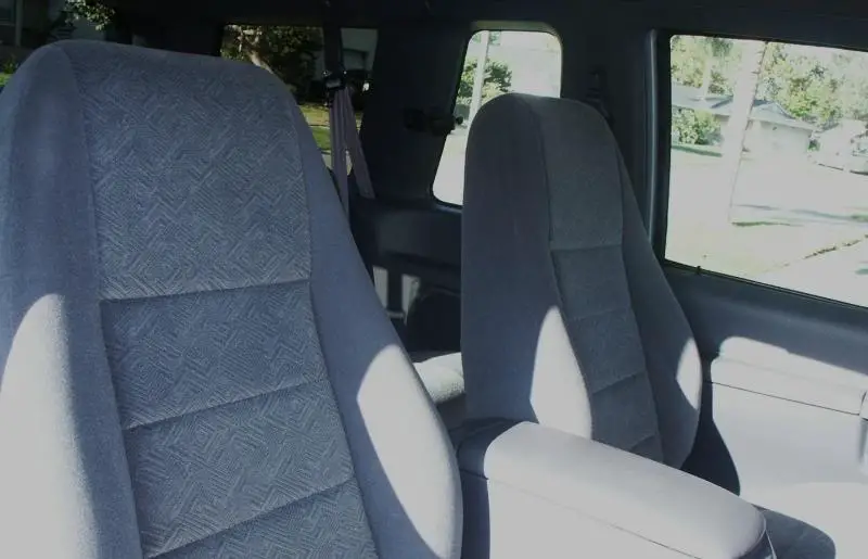

One owner 1998 Sport, light blue, SOHC V6, 5 speed auto. It has just 55,000 miles and is just stunning ... it looks like it has been sealed in a time capsule ... like it is 98% brand new.
Blue cloth interior that is very fresh. The original owner took exceptional care of it, too, larger battery, added a trans cooler, never towed with it (the light pigtail, still in the NOS box, was included however).

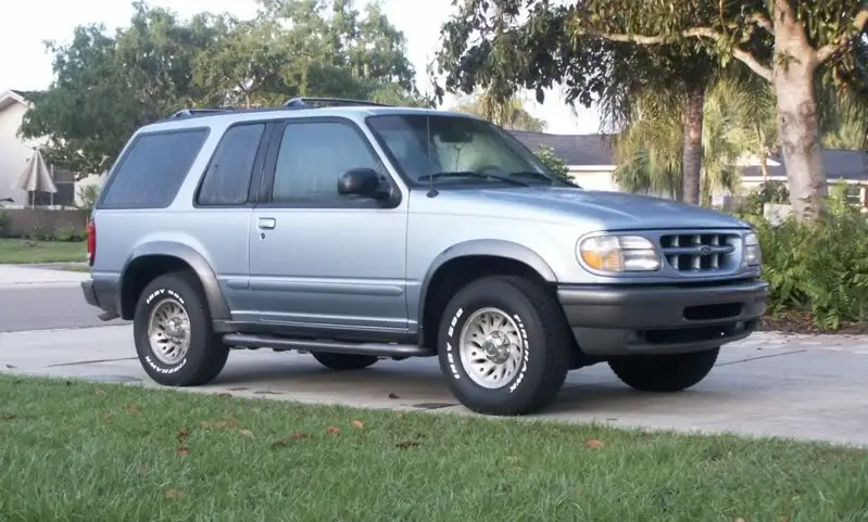

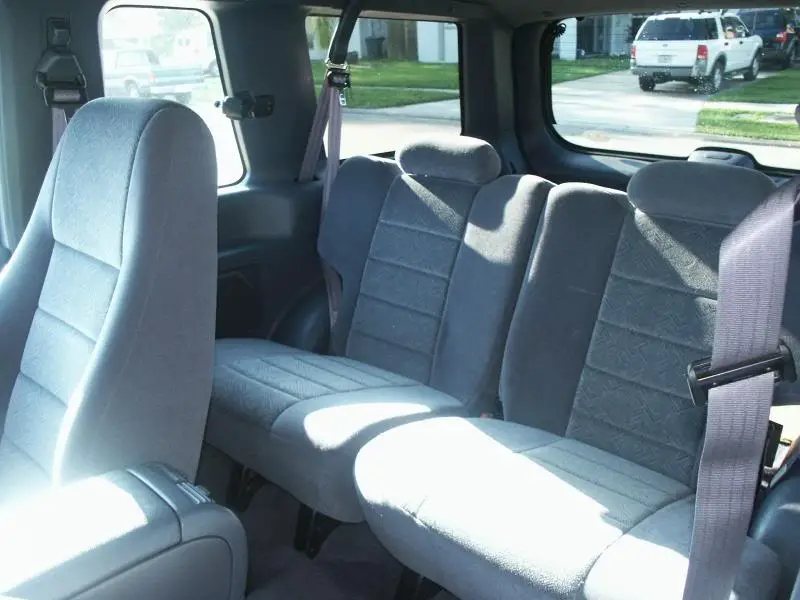

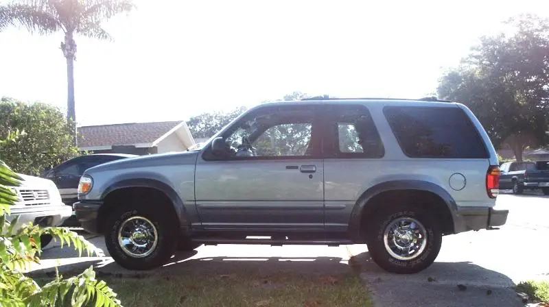

Here are some pictures of "Sporty" ...
Like I said before ... looks like it was sealed in a time capsule ...
I am going to have to take some pics right at sunrise ... they will look a lot better than these... the light is a lot kinder to the camera. I had to tone these down a lot to get the light blue color right.

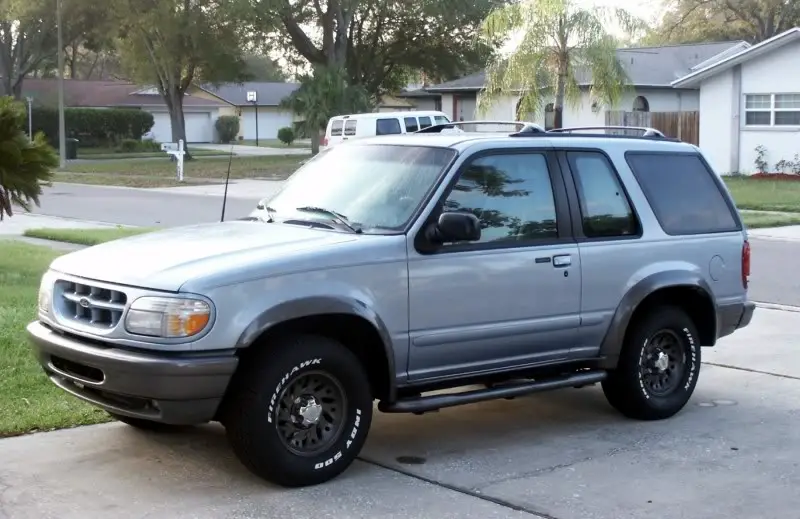

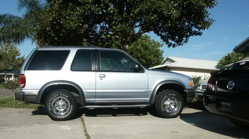

Here are pics after the spring swap and putting some new tires on it ... 255-70-15 Firestone Indys.
And here it is with the wheels painted in graphite paint...
It is finally starting to look a bit custom ... ;)
