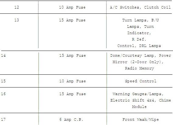

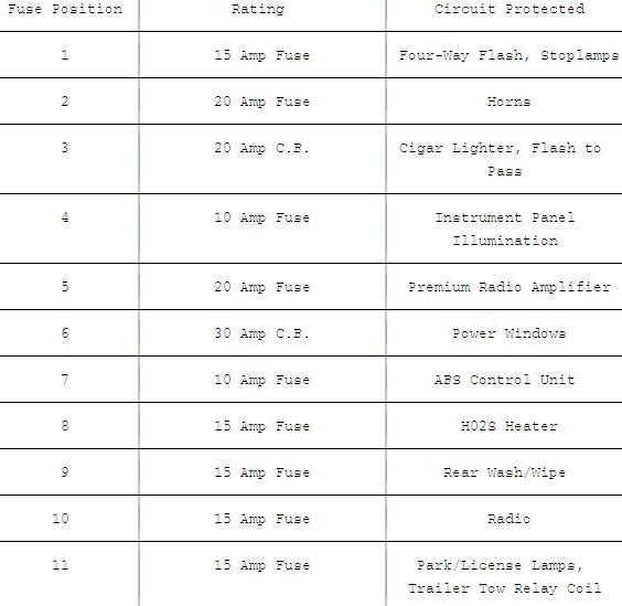

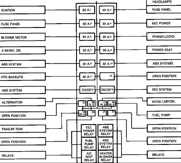

Ask and ye shall receive... both 1993 Fuse Panel Diagrams from the Dealer Service Manual.
arco777, you are the man!!! That is exactly what i needed! Now according to the diagram you posted, it is my fuel pump mini fuse that keeps blowing. Which tells me that either I have a short in the wiring going to the fuel pump or the fuel pump is shot. Which I believe is the fuel pump itself since it has been sounding like a garbage disposal for awhile now. Thanks guys you are awesome!!:thumbsup::notworthy
In tank pump for sure. Ive done a few of those. Make sure you replace the filter at the same time. Kinda spendy tho. The pump that is. I belive the last time I looked it was like a hundred bucks. And if your fuel gauge is on the fritz you might consider a new sending unit. That too by the way is also a hundred bucks. Good luck.
How quickly does the fuse blow? It could be a wiring short and not the pump. Noisy pumps don't necessarily result in blowing fuses. Replacing the pump is a bit of a pita, so make sure that's your problem before doing it.
I would try connecting power directly to the fuel pump harness at the rear of the truck, with a 20a fuse, and see if it blows right away. If it does, the problem is either the fuel pump or the wiring on the sending unit. If it doesn't, you have a short elsewhere.
