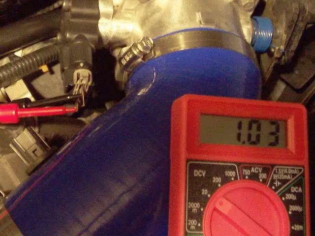

The PCM relies on the throttle position sensor (TPS) to determine closed throttle for idle and all other throttle positions for acceleration or deceleration. A defective TPS can result in unpredictable engine behavior. Testing the TPS is easy and costs nothing. You'll need a voltmeter with a resolution of 0.1 volts or less. Some inexpensive voltmeters only have resolution to 0.5 volts. Also, an analog voltmeter measures continuously with an instantaneous display and is more likely to "catch" erratic characteristics. With the electrical connector connected to the TPS, backprobe (I use long straight pins) the wiper contact (gray/white wire) and the return (gray/red wire). Connect the positive lead of the voltmeter to the wiper probe and the negative lead to the return as shown in the photo below. Do not connect the voltmeter negative lead to ground instead of the return because the sensor return is connected to the PCM and not ground.
Switch the ignition On but do not start the engine. The voltage should be approximately 1.0 volts with the throttle closed. Slowly rotate the throttle plate to wide open throttle (WOT) while watching the voltage reading. It should increase smoothly (with no dropouts or jumps) to at least 4.0 volts but less than or equal to 4.80 volts at WOT (mine read 4.64 volts).
If the TPS fails the above test move the voltmeter positive probe to the PCM provided reference voltage (brown/white wire) and measure the voltage. It should be approximately 5.0 volts. The PCM supplied reference voltage also goes to the fuel tank pressure sensor and the differential pressure feedback EGR (DPFE) sensor. If the reading is less than 1.0 volt one of the sensors may be shorted. Disconnect the TPS electrical connector and measure the resistance of the TPS.
Once the TPS tests good, I suggest that you perform the Idle adjustment procedure

I checked the TPS voltage and it read 1.03 volts at idle and 4.67 V at WOT. There was barely enough slop in the TPS screw holes to adjust it down to 0.98 volts. After adjusting the throttle stop screw, the TPS voltage went down to 0.93 volts. Any further adjustment of the screw had no effect on TPS voltage. In fact I checked the clearance with a feeler gage and the stop was not even touching the screw. With the throttle blade sitting in the bore and not touching the stop screw, and the IAC air bleed blocked off, the lowest idle I coud achieve is 1000 RPM. I adjusted the stop screw until it barely touched the stop, replaced the IAC, and started the engine. The IAC opened to idle at about 1200 RPM, and then reduced idle to 1000 RPM, so it's functioning properly. I am now begining to suspect a vacuum leak somewhere, contrary to what I thought before.

You shouldn't really hae messed with that minimum airflow screw, but now that you did... a couple things you need to know. First, the throttle body and plate are teflon coated from the factory, to keep them from gumming up so easily. You're not supposed to clean it with any solvents. But, I have found that since I don't mind cleaning it once in a while, I usually don't pay attention to the sticker that says "dont clean me".
But once you clean it, you may have to clean it more often in the future. Next, that minimum screw shouldn't have been altered. It is more complicated than that, but basically here's the deal. The screw sets the minimum amount of idle RPM ever to be achieved. Usually, that's like 5 or 600 rpm. The IAC's job is to control the actual RPM, but minimum idle cannot be say 800, because that leaves no room for the IAC to go below that. In order for the IAC to work correctly, it needs room in both directions to move. Usually about 30% down and 70% upward. The PCM controls idle from 2000 rpm or so (high idle when really cold out) down to a less than stock idle, in case the RPMs are too high for some reason (vacuum leaks or something). So in order to give it room to work, we want about a 20 - 40% duty cycle at idle. You can see that in a scan tool.
Without that, just try adjusting the minimum airflow screw until you get a .98v TPS reading. Typically, most cars are about that unless they have a sticking throttle plate. When the throttle body is dirty and won't quite close all the way, you might see a 1.1v idle, which is too much due to the dirt. So before you do anything, clean the throttle body somehow (even if its just water and a paper towel, if its already nice and clean). Then, clean the plate edges themselves. Then, set the TPS to produce .98 at idle. That should get you close. If you had 1.05v before, probably it was just because of some crud on the throttle body or plate.
Also know that the minimum screw keeps the plate from binding in the bore when you let off the gas fast. Otherwise, it could get stuck closed. So for that reason, there should always be some opening of the throttle plate, just to keep it from sticking.
The elongated holes in the TPS, contrary to popular belief, are not adjustment slots. One hole is simply elongated to make it easier to install the TPS without it sticking to the screws too much. Granted, this light slop can be used to adjust the TPS, but you shouldn't need to if you have a stock cam profile.
Using your voltmeter, measure the TPS voltage if you let off the gas (engine off, full throttle, key on) nice and easy. See where the voltage stops. Then floor it and let off fast, snapping the throttle plate shut. See where the voltage stops there. If there is no dirt involved, both should end up at the same voltage within .01 or so. So clean the TB, set the TPS to .98 (or just loosen the screws, let it settle wherever it wants to, and then retighten the screws... no adjusting). The TPS should be right at 1v or slightly less. If not, find out why.

OK, I went thru your entire procedure in detail:
TPS voltage was reading 0.98 volts.
Idle was at 1000 RPM.
I unplugged the IAC and the idle fell to about 600 RPM.
At this point, I plugged the IAC harness into my "old" IAC and laid it up on the intake hose next to the installed IAC. This was to keep the ECM happy. No CEL. Good.
I drove the vehicle to Kerrville and back, with a couple of stops along the way. About 60 miles R/T. The idle was reading about 600 RPM and the truck drove just fine with the IAC disabled. I like the lower idle speed. But, it's 100 degrees here today! May not be so good when it's cold out.
Got back home to Fredericksburg and let it cool off a while.
I set up my voltmeter to read TPS voltage again. Reading was 0.98 volts.
I then backed off the throttle stop screw until the TPS voltage quit falling at about 0.92 volts, then advanced the screw until it contacted the throttle stop and TPS voltage increased to 0.94 volts. This was to make certain that the throttle was stopping on the screw and not in the bore. Then I readjusted the TPS to read 0.98 volts. The engine idled at 450 RPM.
Turned engine off, plugged the IAC back in again, and started the engine. Idle was about 1100 RPM, but decreased in steps to about 850 RPM, it's lowest. Drove the truck around the neighborhood and it seemed to drive much better, even though the idle was at 1000 RPM when I stopped, but decreased to 850 RPM after a few seconds. So, I can probably live with it.
I still think I may have a problem with the ECM holding idle too high too long.
