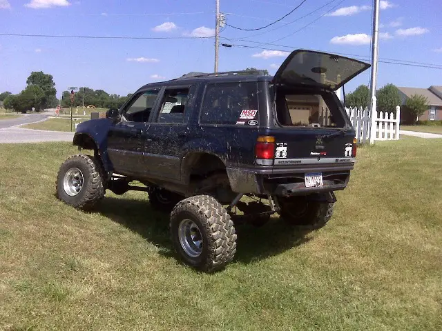

I just realized I never registered mine...
D44 Ft
D60 Rr with disc brakes
Leaves front and rear
35 in Swampers and 5:13 gears
BW4406 Tcase
thanks to all the people on this site that helped, Couldnt have done it without this site.
Still working on perfecting it, needs the cage and bumpers finished...but here it is:

Lemme ask u something in that first pic with the truck in front of the garage i had to really look at it carefully it looks like the roof and back hatch is taken off it looks like it fits the truck. Just camera tricks i guess
^^^ yeah looks like a convertible to me in the first picture ;):thumbsup::confused:
Hmm.... this is odd and different?... Removable rear? It's like an easter egg.. lol..
Yeah I chopped the top and going to buld a full cage. Im making a custom cover from Army Tent canvas. Thats the vague plan, Details will come as they come.
The idea is a fully capable trail rig, ready for anything and any terrain. having the top gone will help in sevaral ways to include visibility, gear storage, and center of gravity.
But for now its just a cut up Mountaineer with an SAS...lol
Thanks Yall.

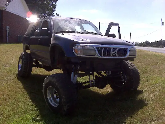

I am guessing the front axle came out of a 78-79 F250? What can you tell me about your steering setup?
Damn those shackles would scare the crap out of me, way too long and to me unsafe.

The shackles werent unsafe. I was using them on an off road vehicle as an intended point of weakness, (weak link in the chain) if something happened the shackles would bend first, showing out in alignment, or showing in after action inspection. I used the same system on two different Blazers, and every time something crazy happened an inspection after the run would show a torqued shackle, and it cost about 16 bucks a set to replace them (carried 4 spares at all times). It really helped with the steering box ripping off the frame, and saved front end parts left and right. they flexed well, and the length helped with driveline angle as the axle dropped. The system was never intended to support extended on road or daily driven use, and took ALOT of abuse with no issues whatsoever.
