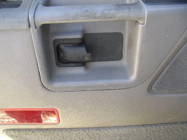

...I broke my Interior Door Handle due to age, heat, and it just getting wore out...This was the drivers side rear door that I replaced on my first gen X...
...After removing the door panel (white dust plastic cover sheet does not need to be removed. Mine was removed by previous owner), this is what you will have to work with...There are 2 screws you will have to remove...
