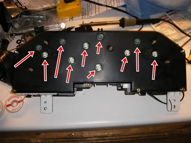

You can install LED's in the 3rd Gen instrument cluster! Use this thread for removal of the instrument cluster, thanks to XtremeRanger for the excellent write-up!: http://www.explorerforum.com/forums/showthread.php?t=218636
Once you have the cluster removed you can change the bulbs over to LED's. The sockets twist out. Replace the bulbs with the appropriate LED's and you are good to go!

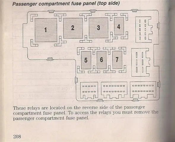

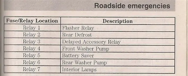

Can't say for sure about the rear defrost but from the clicking, it sounds like the relay. According to my owner's manual, the relay for the rear defrost is located on the back side of the fuse panel located under the driver's side dash. If you don't have an owner's manual, Dead Link Removed.
