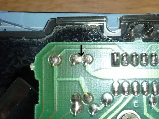

If you have a tach that you think has gone bad just because it is always up around 3000 rpm? It's not busted - just needs some old fashioned TLC... Here goes:

6. Put the tach down on a cloth or something soft so the dial/needle don't get damaged. Take a look at the soldering on the "top left" of the circuit board. You'll more than likely find some cracks in one, two, maybe a lot of them. These are the ones that need repair - duh... :p:
7. Warm up the soldering iron and slowly fill the cracks up. I managed to get away with using just the factory solder. If you get impatient and pull the solder off with the soldering iron, you'll need to re-fill with your own solder.

Sounds like you may have some failed soldering. Generally speaking they fail to around the 3000rpm point, but I suppose this could differ. Sometimes mine would creep up to 4000ish but then come down later. If it goes straight up with the engine off but key on, then it's probably soldering.
