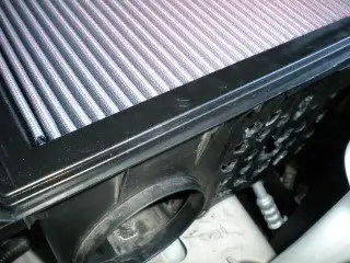

3. remove the filter...
4. the bottom 1/2 of the box is held in by 4 rubber gromets, 2 on the bottom of the box, and 2 on the fender side of the box. gonna have to wiggle the box loose a bit then yank it out. might be a little tough, might have to use a little force.
5. the silencer is the 6-7'' tube thats in the box ( the only 1 ) pull this out...
6. drill holes in the walls of the box. i did the FRONT, and FENDER SIDE, and the BACK SIDE of the box... leave the side of the box facing the engine alone, it some what acts as a heat shield...

* after running the mod with just the hole drilled on the front / side / back of the box. i did just cut around the edges of the front holes, and now there are 2 large holes in the front side of the box only...

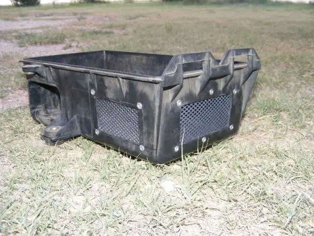

I drilled about 1/3" holes on my Airbox, probably about 20 total. I was going to bore them bigger and add more, but I might just do something like this:
